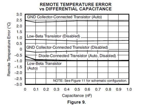

1. Is there any possibility (programability) to have intermediate points between 1.042759 and 1.747977 (just not listed in the n-factor range table of TMP441), like 1.06XXX
2. Does auto beta correction is applicable to diode connected (base and collector shorted) PNP transistor?
