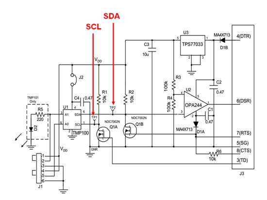

    The TMP100 would be an I2C slave.  It looks like you could pick off SCL and SDA from test points one and two (respective) back to your FPGA board.  The TMP100 is actually supported through our Temp Sensor forum, so I'll move your post there and perhaps get you a more complete answer/solution to your problem.
  • Fradaric,
    1) As seen in the schematic below you can connect to SDA through test point TP2 and SCL through test point TP1.
     2) While implementing I2C communication using the TMP100 the master will be the micro controller or FPGA. The TMP100 is the slave.
    3) By default the TMP100 will provide 9 bits of resolution. You are able to change the resolution to 9, 10, 11, or 12 bits. This is done by setting bits R1 and R0 in the configuration register to the desired resolution as seen in Table 8 below. The most significant bits in the temperature register are used with the unused LSBs set to zero.
  • Since I am using TMP100 Evaluation board, how can I power up the device. I don't wanna coonect it to a PC via RS232.
  • Fradaric,
    As seen in the schematic above you can hook up a separate power supply to J1 pin 1. The TMP100 can operate at a supply range from 2.7 to 5.5V. The most common voltage to power on this device is with 3.3 V.

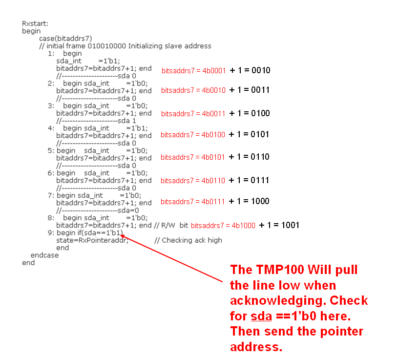

  • I need continuous temperature values, so In my design I put  '1001000' after the start bit and again '0' as R/W then waited for ack an then  '000000-00(P1P0) like that. Is it the right procedure?
    Verilog code with in-out pin is difficult to check via test bench, so I need someone to verify my design.
    Here is my code

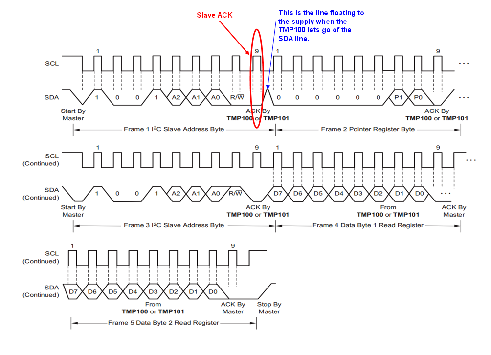

  • Fradaric,
    I looked through your code and found the following error. It looks like you are checking for the TMP100 to ack high. The TMP100 will pull SDA low when it acknowledges. Try changing this and then send the pointer address when the TMP100 pulls the line low. I attached the timing diagram for convienence below. Please see the 9th bit. We can step through debugging this together after this change is made. Also I would recommend using an oscilloscope on SDA and SCL while you are debugging. It will help to see what is being sent out on the communication lines.

  • Yes, I found the code. But I would like to know about my design too. Can I proceed with the code I've shown you? is there anything wrong you feel, and what about configuration register settings?
  • Fradaric,
    I do not see in your code where the last 3 bits of the slave (TMP100) address comes from. Specifically the address should be a 7-bit address that is either
    1001000, 1001001, 1001010
    As I pointed out above you have indicated the first 4 bits 1001 and check for a slave acknowledgement. I do not see 1001 followed by the rest of the address. The edges of SDA also appear to coincide with the clock edges of SCL which is not valid in I2C. There is a setup time requirement that must be met with I2C. Specifically this is a 100ns setup time that can be seen on page 10 of the data sheet.
  • case(bitaddrs7)
            // initial frame 1001000 Initializing slave address
                1:    begin
                    sda_int                =1'b1;     //---------------------sda 1
                    bitaddrs7=bitaddrs7+1; end
                2:    begin sda_int        =1'b0;//---------------------sda 0
                3:    begin sda_int        =1'b0;//---------------------sda 0
                4:    begin sda_int        =1'b1;//---------------------sda 1
                5: begin    sda_int        =1'b0;//---------------------sda 0
                6: begin    sda_int        =1'b0;//---------------------sda 0
                7: begin sda_int        =1'b0;//---------------------sda=0
                8:    begin sda_int        =1'b0;
                    bitaddrs7=bitaddrs7+1; end // R/W  bit
                9: begin if(sda==1'b0)
                    ack=1'b0;
                    state=RxPointeraddr;            // Checking ack high
                    end
        endcase
    I think this is what you talking about! right? the cases 1 to 8 indicates the address 1001000 and the 9th case is R/W and that is zero as per the timing diagram. Then??

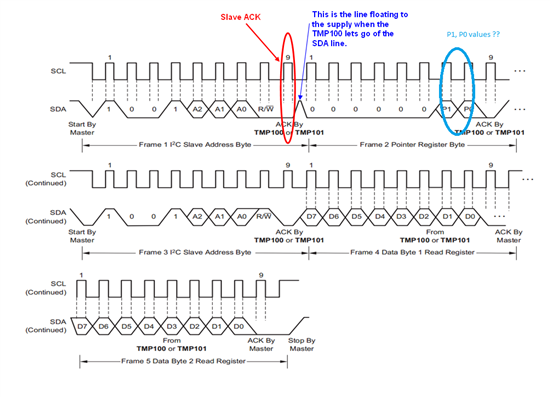

  • Let me know the values in  P1 and P0, In order to get  data output from TMP100. (I am putting '00' now)
    And I am confused with adding setup time into my design.  Someone please help me..... how to include  setup time??
    Also I would like to know the configuration register settings, Is it included In the timing diagram? I need a resolution of 12 bits, how can I do that?
  • P1 and P0 form the pointer.  The pointer tells which register you will read or write to.  There are four different registers in the TMP100.  The pointer will determine which of the four registers that you read or write to.  Table 2 on page 5 of the data sheet tells the value of P1 and P0 required to write or read each of the registers.  For example, if P1/P0 = 00 you will read from the Temperature register.  If P1/P0 = 01 you can read or write to the configuration register.
    To change the resolution to 12 bits you need to write to the configuration register.  Table 6 shows the format of the configuration register.  Bits 5 and 6 set the resolution.  These bits both need to be high.  Of course you must write all the bits of the configuration register, so when you set the resolution you will also change other configurations.  You will need to determine what you need all the other bits in the register to be.  If you don’t want the part shut down and you don’t care about the alert status the configuration below should work.
     0110 0000 == sets resolution to 12 bits, continuous conversion

  • Fradaric,
    Please see table 1 and table 2 in the product datasheet on page 5. The pointer register is an 8-bit register. Bits P0 and P1 are the least significant bits within this register. These bits are used to address the other four registers in the TMP100. With P1 = 0 and P0 = 0 you are talking to the temperature register as seen in Table 2.
    If you would like to configure the device to 12-bits of resolution you will need to address the Configuration register (P1 = 0 and P0 = 1) and perform a write operation as seen in Figure 6. Setting bits R1 = 1 and R0 = 1 in the configuration register will configure the device to provide 12 bits of resolution.
    For each clock pulse the data you are sending needs to be setup or valid before a rising clock edge. In other words if you want to send a 1 than that 1 needs to be setup at least 100ns before the next rising clock edge. Please refer to Figure 5 in the datasheet. Specifically see tSUDAT in this figure for a visual description.
