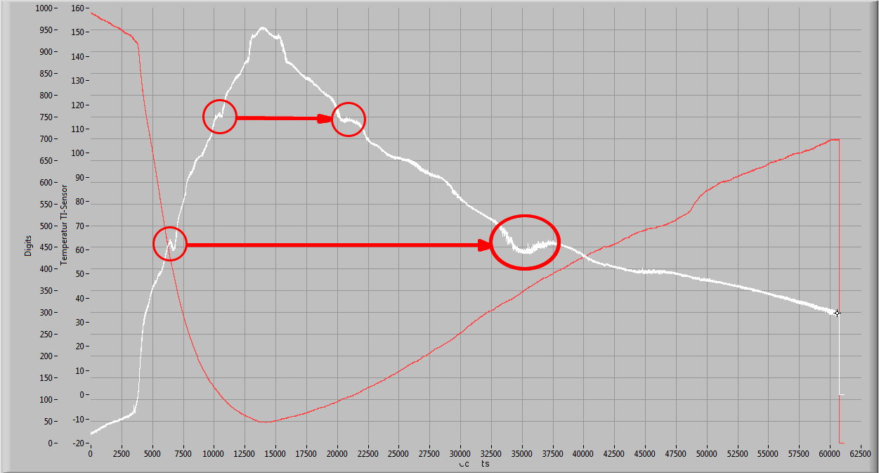

I observed a strange measurement with the LM95071.
First some words about me and my project.
My name is Rainer Balzerowski and I'm from Hamburg, Germany.

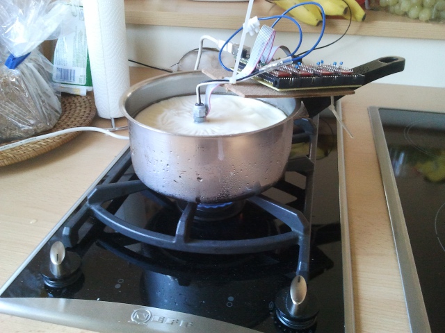

For a private project I want to find out the characteristic curve of a (very cheap) NTC Element.
So I build a simple test where I put the NTC together with the LM95071 in cooking oil and freezed it to -18°C.
Then I continuously warmed it using the smallest flame of my gas stove.
Then I compared the measured temperature of the LM95071 with the NTC result.
(The NTC is connected to the ADC of the micro-controller using a voltage divider circuit.)
What I found is that the readings of the TI LM95071 are not continuously rising (falling).
While heating the oil the temperature goes down at approx. 60°C and 115°C.
It rises while the oil cools down at the same temperatures.
In the diagram below the white line is the temperature read from the LM95071 (right scale in °C). The red line is the ADC Measurement of the NTC (0-1023 digits - 10bit ADC)
Is this typical for the LM95071, or am I missing something?
Any help will be greatly appreciated.

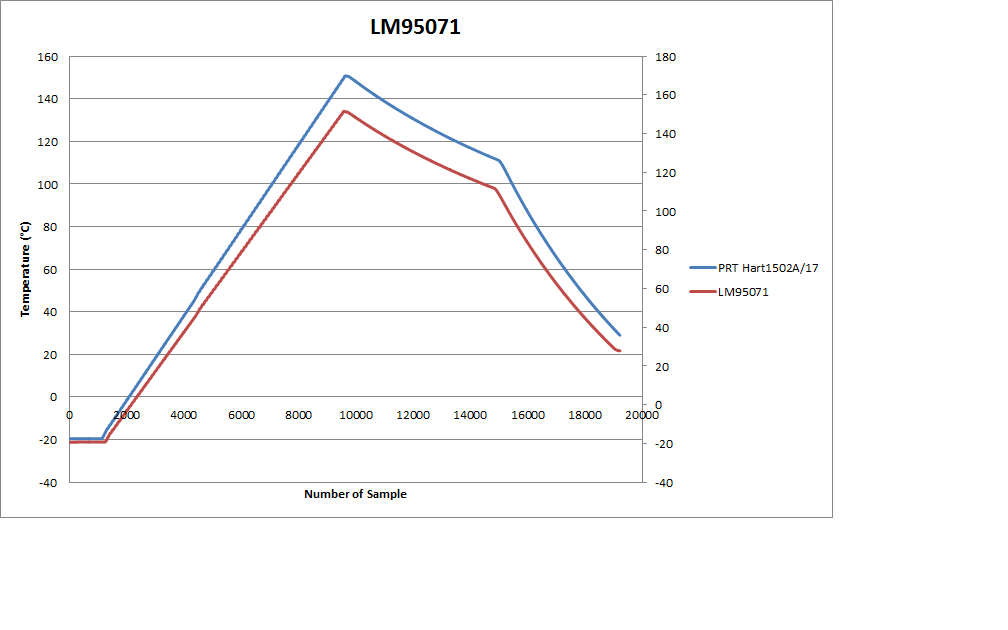

  • Hi Rainer,
    Sorry for such a delay. I do not believe that our device performs such a manner, so I decided to duplicate your setup. However, my system is a bit different than your setup. I was using the Cypress microcontroller to communicate to the LM95071 via SPI protocol. I used the oil bath to heat up and cool down the temperature, and the Fluke (formerly Hart Scientific) precision PRT to monitor the temperature. I tested on the bench and was not seeing what you are seeing. Could it be your system setup? Here is the data attached.
    Please let me know if you have further question.
