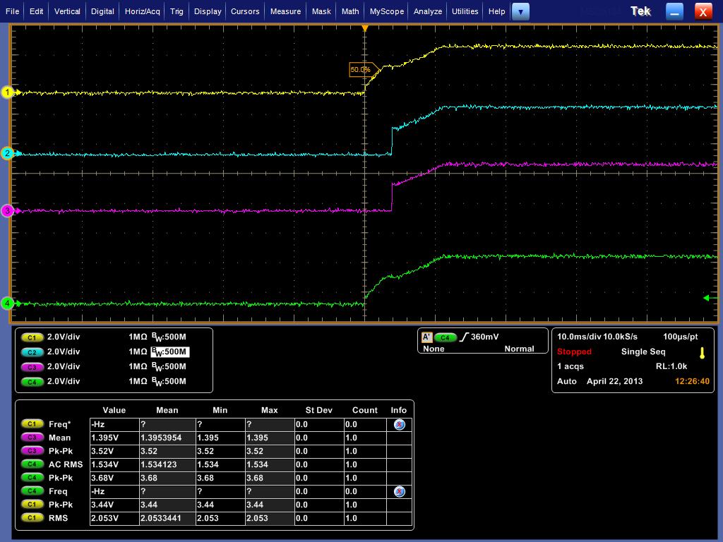

LM95172 is a 200C sensor. We are testing it till 190C. Normally when powered up it works well till 190C most of the time. But if we power cycle at 190C the IC stops working. It's connected on a SPI bus. We monitored the SPI bus to see we stopped receiving data when we power cycle the chip at 190C. Once the temperature is lowered to 180C the chip starts responding again with data.

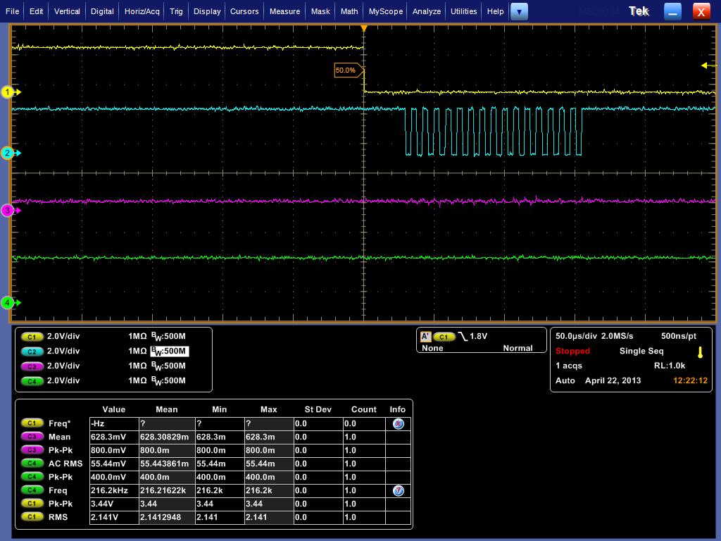

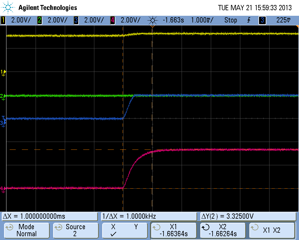

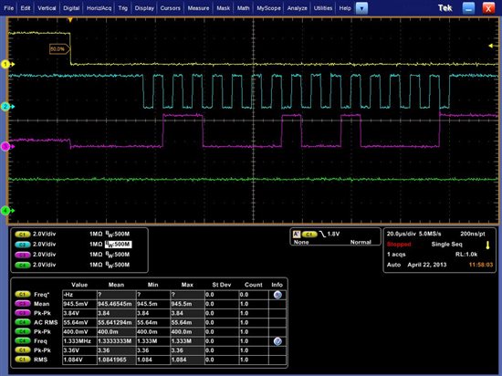

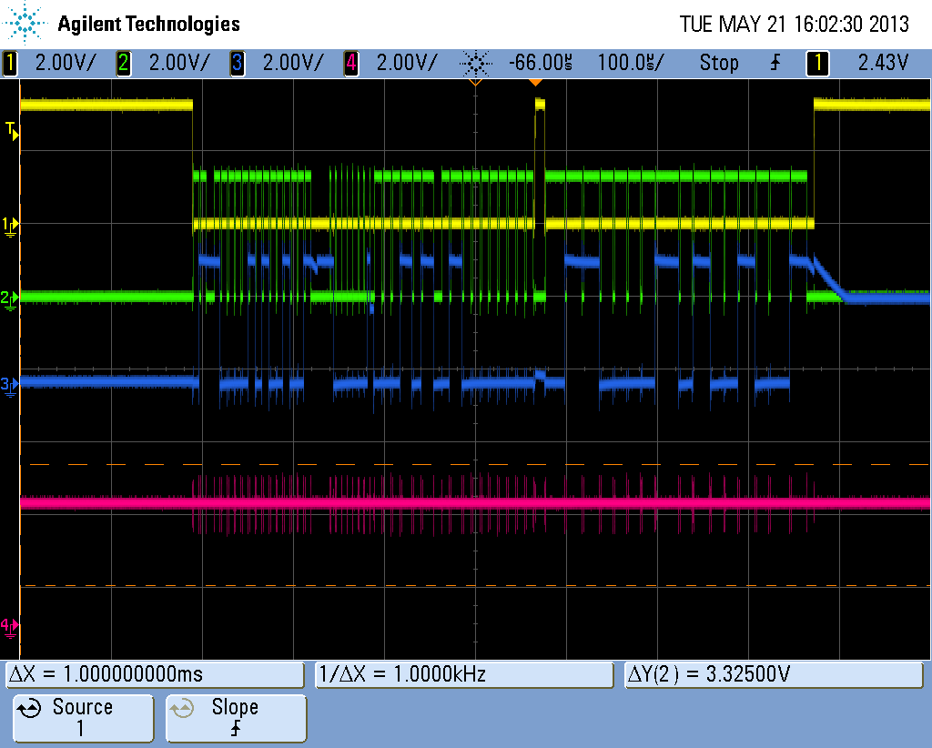

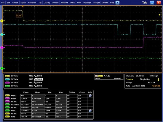

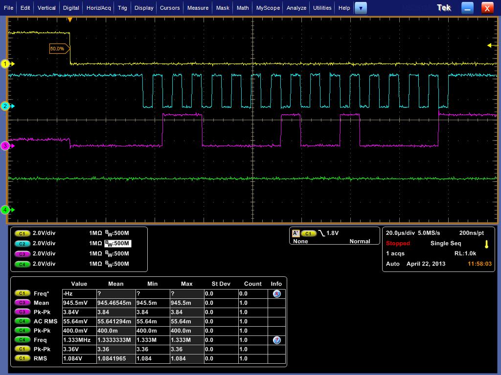

  • Thanks Aaron Heng for the reply,
    I am attaching the required screenshots here.
    We test it on our PCB board. We put the complete board into the oven and heat it to ~190C.
    #1 - Working at 190C
    #2 - Working at 190C
    #3 - Power cycled at 190C
    #4 - Not working at 190C (after power cycle)
    #5 - Not working at 190C
    Hope this information is enough for you.

  • Hi Aaron,
    - Our Vdd and Vio are the same, so no lag between them.
    - Our power up ramp is very steep and we come to  power in less than 5ms
    Is there any other concern you may have ? The software reset scheme also is implemented.
  • Hi AQ,
    Thank you for providing the snapshot, and I would like to inform you that I am still working on your issue. We never face this issue before, and I am stuck right now.  We might need your help to get a better understand on your end. Could you provide me a complete waveform of the SPI communication? On your snapshot #5, could you please zoom in when the CS takes “LOW”? I would like to see if there is a pulse on the data line.
    I tried to duplicate your setup. The only difference between yours and mine setup is that I inserted the LM95172 and bypass caps inside the oven not a complete board setup.  Since you placed your board inside the oven, could you make sure that your discrete components can handle at high temperature?

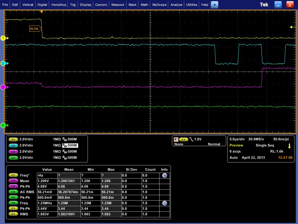

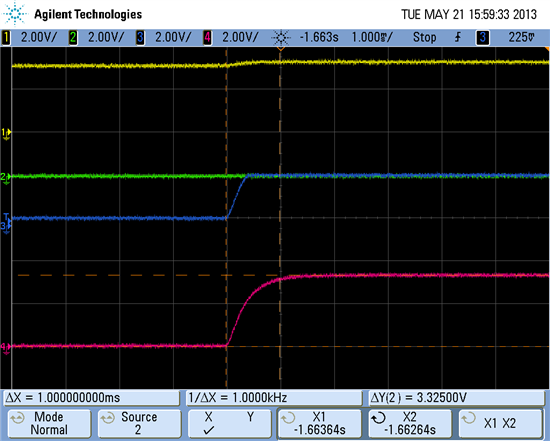

    Here are some of my snapshot pictures.
    Channel 1 => CS
    Channel 2 => SCLK
    Channel 3 => SIO
    Channel 4 => Vdd
    Vdd Ramp Rate at 190°C. I noticed that your Vdd ramp rate seem to be brutal.
    I turned power off and on at 190°C, and it was still working. If you look at the first 16-bit, the temperature turned out to be 194°C. I even ramped up to 197°C, and nothing seems to be suspicious.
    When you give me a complete waveform of the SPI communication, I will try to generate a similar waveform to see anything comes up.
