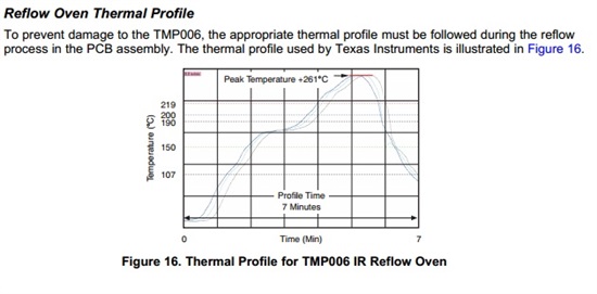

    Also, adding on to what Ed has just explained, if you refer to the following pic from the document that he pointed out:
    As see in the above graph the temperature during the re-flow process is not to exceed 261 degC. Since you mentioned that hot rot temperature was set to 310 deg C, this most likely damaged your part.
