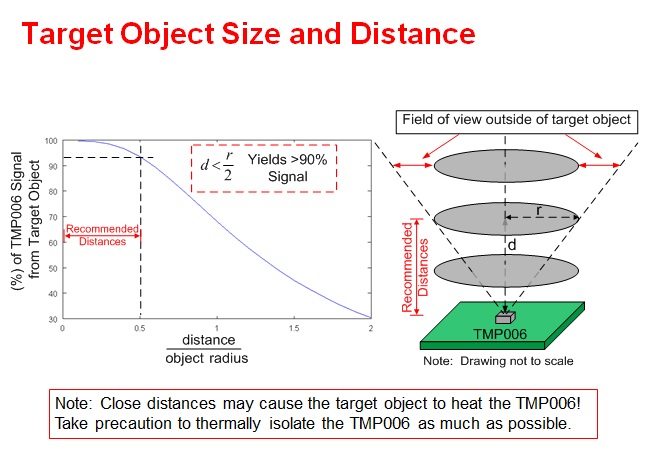

- Does measurement accuracy get worse in distance?
Are there related data and distance permitted then?
    Yes, for a given application the accuracy of TMP006 decreases when the distance of the object varies. How ever if you follow the recommended distances for your application along with the field of view requirements and then when you calibrate the part (without altering the setup any further) you should be able to achieve accuracy as per the data sheet. The general rue is the distance of the object from TMP006 has to be less than half of the object radius.

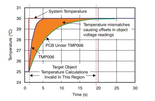

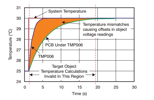

    - Although cared about the measurement accuracy of IR sensor worsening by the rise of ambient air temperature (Local),
    Does Fig. 3 of URL show the graph after the calibration was carried out below? I will get back to you on this upon consulting the concerned engineer who performed this test.
    And if there is the method of maintaining the measurement accuracy of IR sensor, please let me know.

  • Hello Satoshi,
    Figure 3 of the document highlights the effect of offset caused due to the difference in time constants(K) between PCB and TMP006 sensor. This topic does not address calibration of the device. All its trying to explain is that, temperature mismatch occurs if you do NOT follow the recommended guidelines to match the Thermal Time Constants (kTMP006 ≅ kSENSOR_PCB).
    The purpose of the graph is to depict what would happen if you don't follow the guidelines.
    Hope this answers your question.
