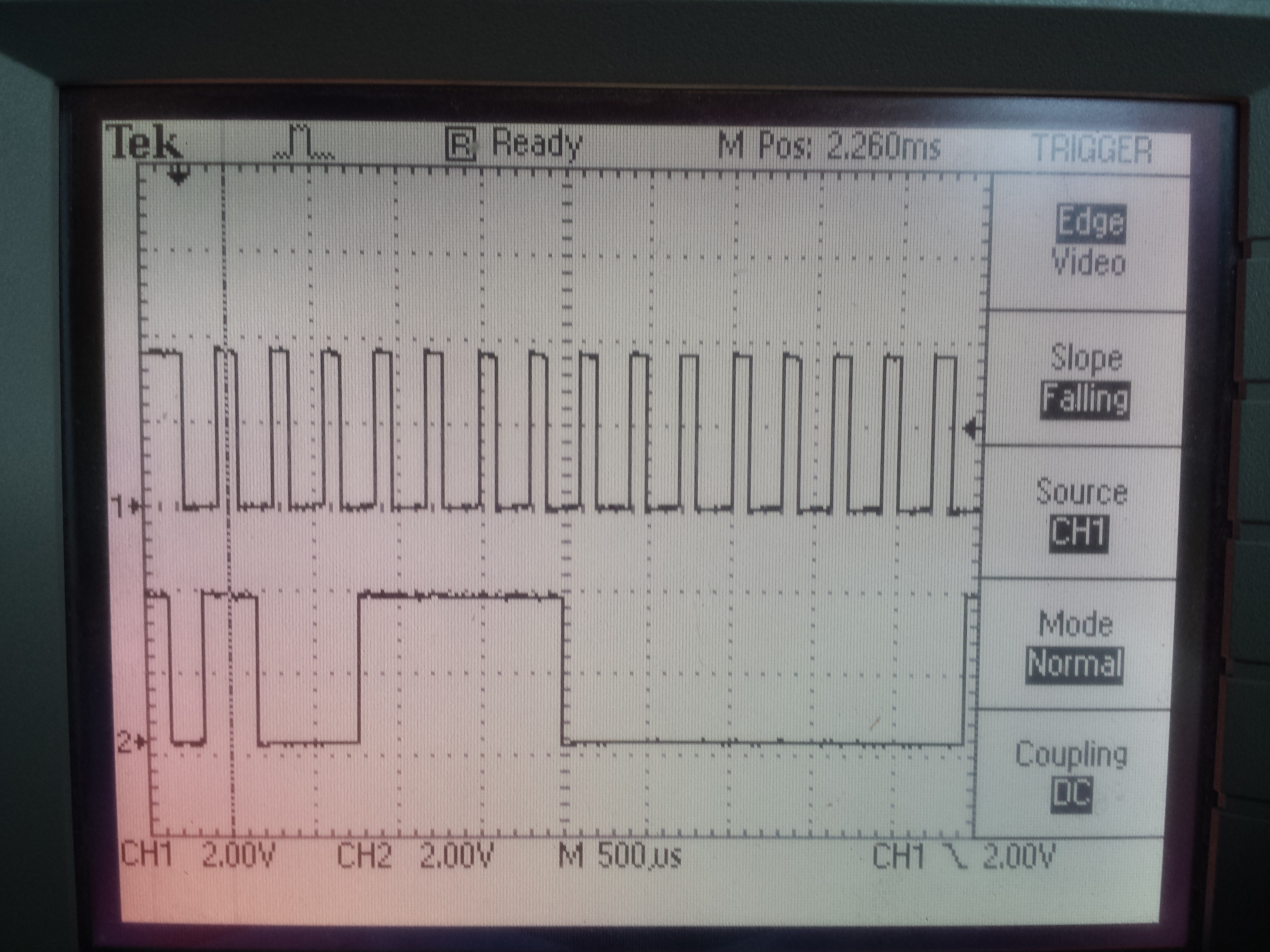

I am attempting to read/write to a TMP275 using an MSP430G2553 (Launch Pad), using the IAR compiler.
The TMP275 has 8K pullups to Vcc on SDA and CLK, stealing power from the Launch Pad.
The TMP275 address pins are tied to Vcc.
I can write and read the control register just fine...
When writing, then reading either TLow or THigh, the 1st byte works as expected, but the second byte always returns 0xFF.
I am aware the G2553 has IC2 capabilities, but I want to use/save the uart for a comm link so I am bit banging the IC2 to run the TMP275
IAR Code:
    WriteTMP275IntToPointer( TMP275_7, TLOW_REG, 0x1230  );
    Temp2 =  ReadTMP275IntAtPointer(TMP275_7);
I have photos of my Oscope writting/reading the data, but at 25MB, zipped, it was to large to include here.
(I can email them individually to you, if you wish)
See the bottom of this file for the definitions of constants.
Thank you.

  • More info:
    Reference: www.ti.com/lit/ds/symlink/tmp275.pdf

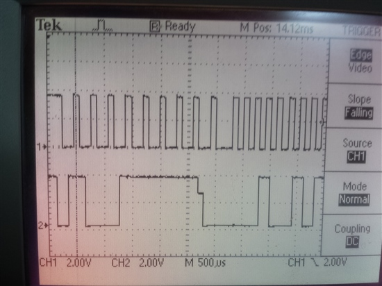

    Master Start, followed by Slave Address Byte:
    The vertical cursor is on bit 1 of Frame 1, of figure 5, as found on page 10 of TMP275.pdf  (A0,A1,A2 = Vcc)

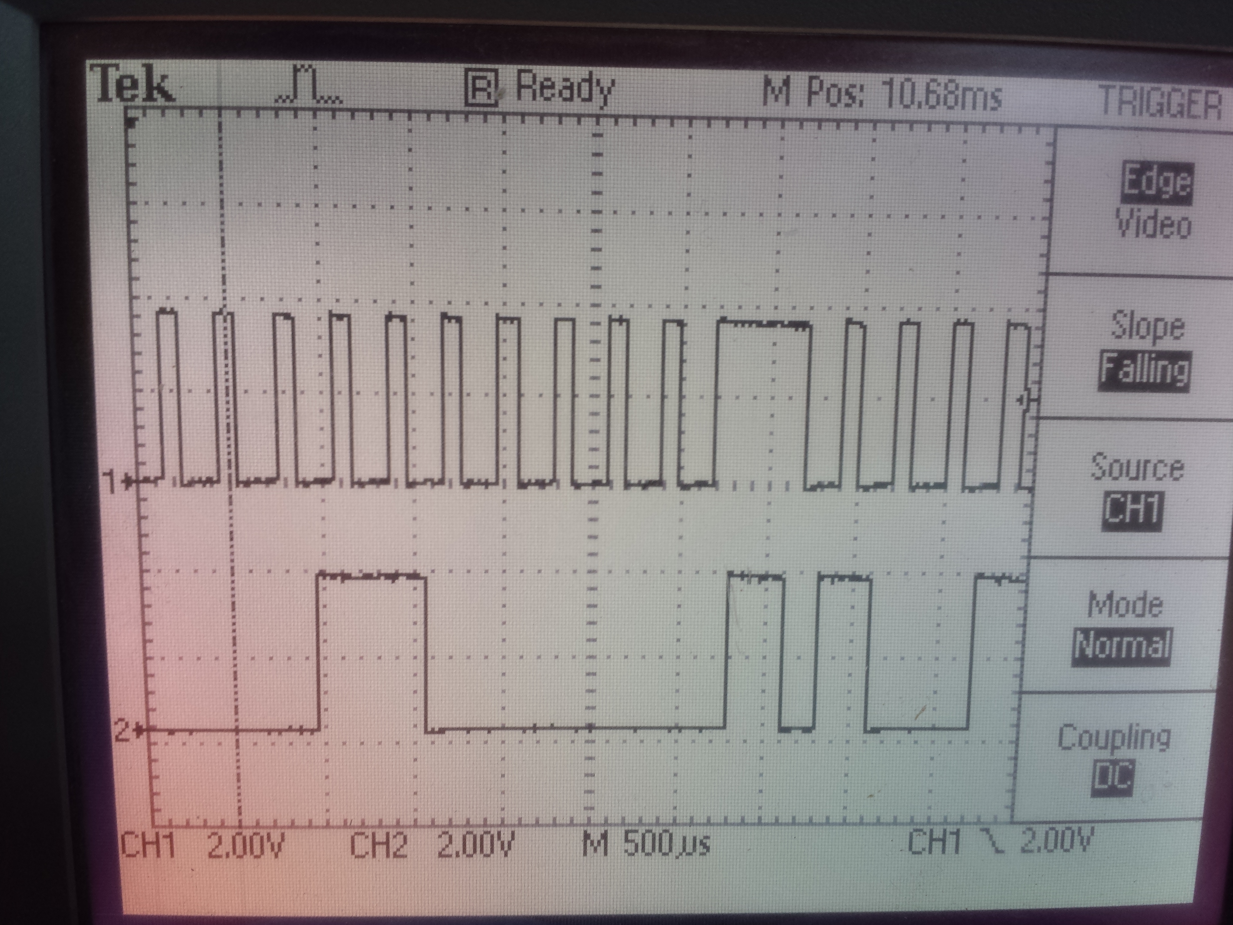

    Pointer Register Byte: (TLow)
    The vertical cursor is on bit 1 of Frame 2, of figure 5, as found on page 10 of TMP275.pdf  (A0,A1,A2 = Vcc)

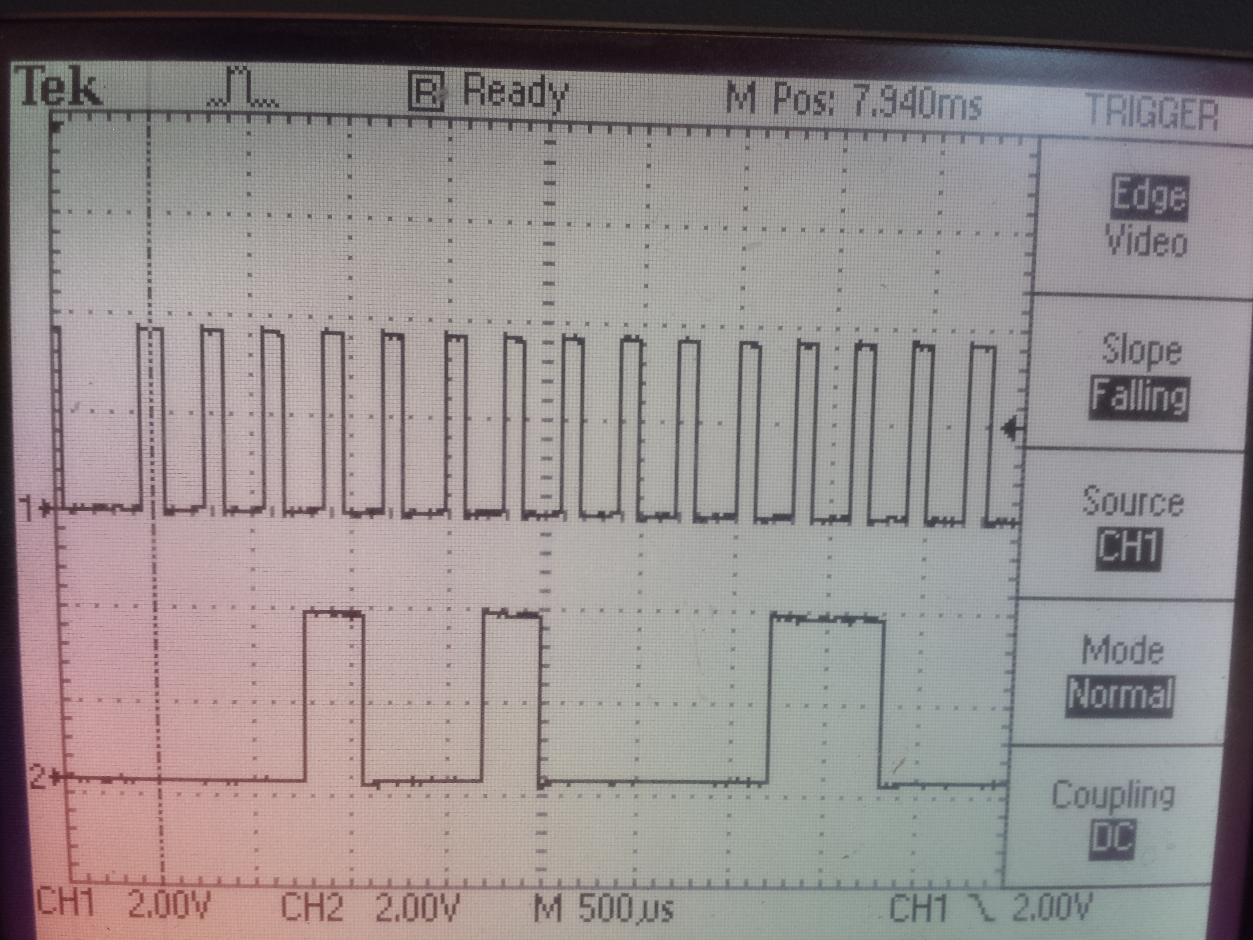

    Data Byte 1: (TLow = 0x1230)
    The vertical cursor is on bit 1 of Frame 3, of figure 5, as found on page 10 of TMP275.pdf  (A0,A1,A2 = Vcc)

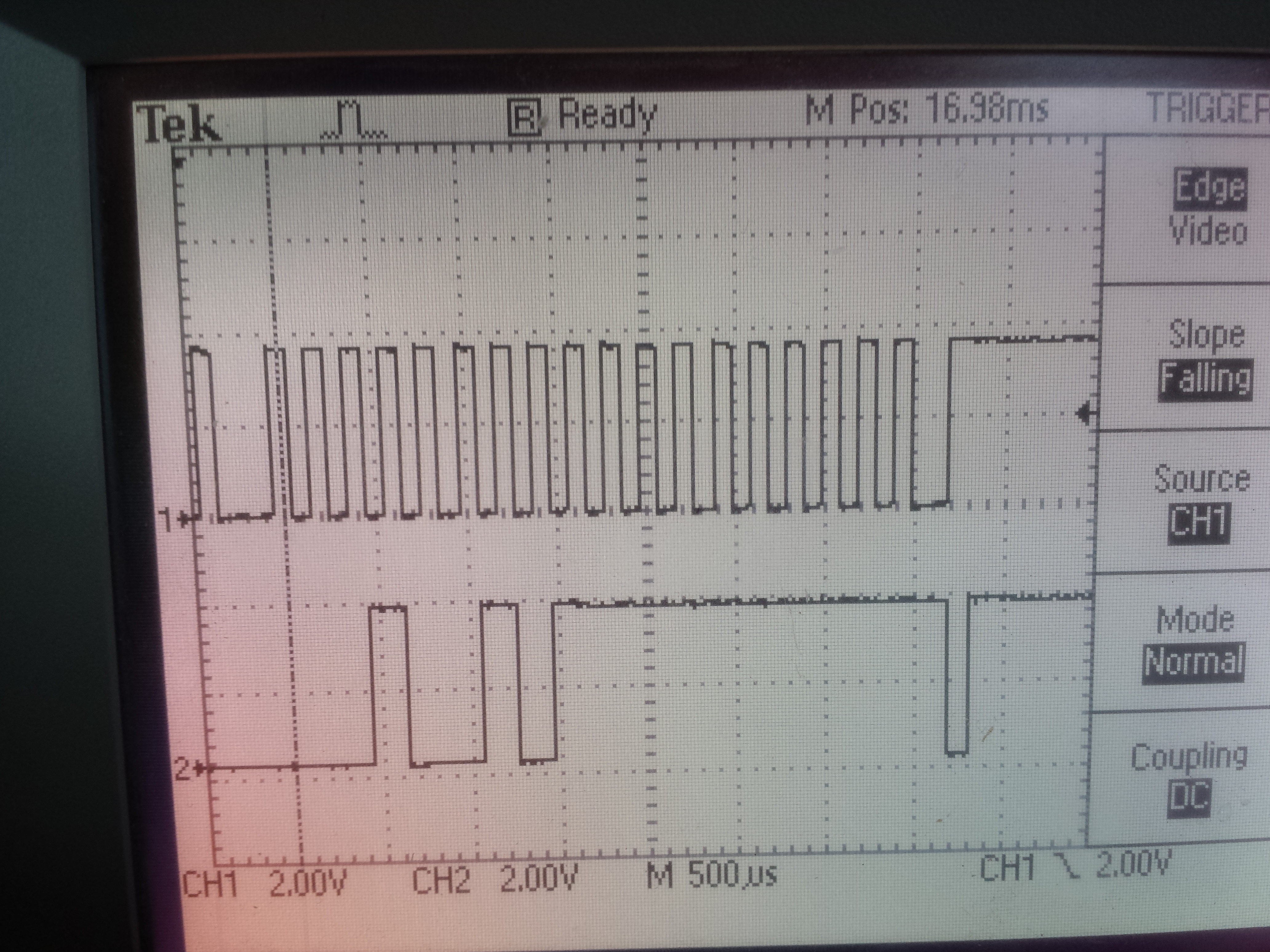

    Data Byte 1: (TLow = 0x1230) (The "30" is being written), followed by Master Stop
    The vertical cursor is on bit 1 of Frame 4, of figure 5, as found on page 10 of TMP275.pdf  (A0,A1,A2 = Vcc)

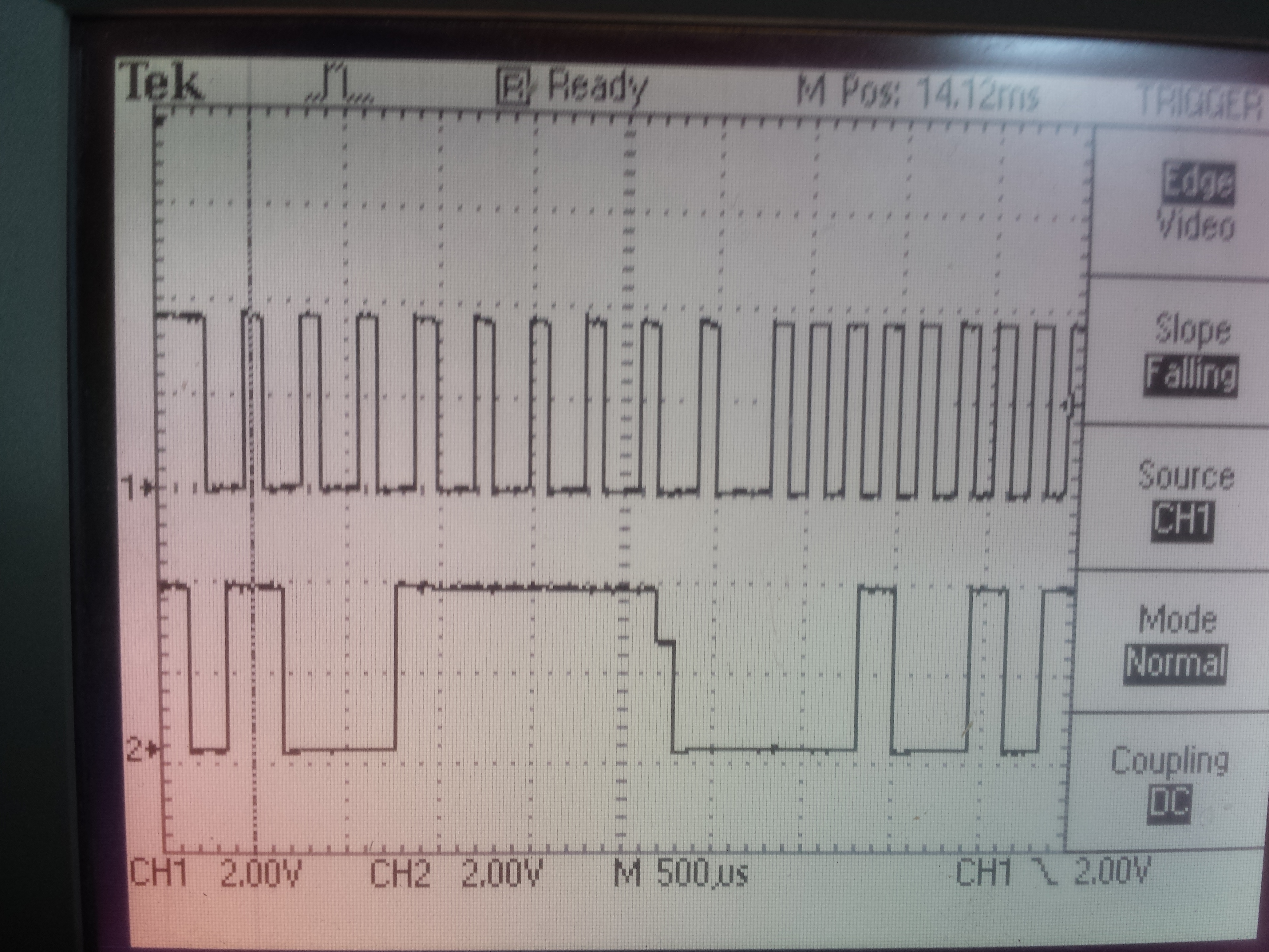

  • Since the pointer is pointing to TLow, we should be able to read it, without Frame1 and Frame 2 from page 11 of TMP275.pdf
    Master Start, followed by Slave address (7)
    The vertical cursor is on bit 1 of Frame 3, of figure 6, as found on page 11 of TMP275.pdf  (A0,A1,A2 = Vcc)

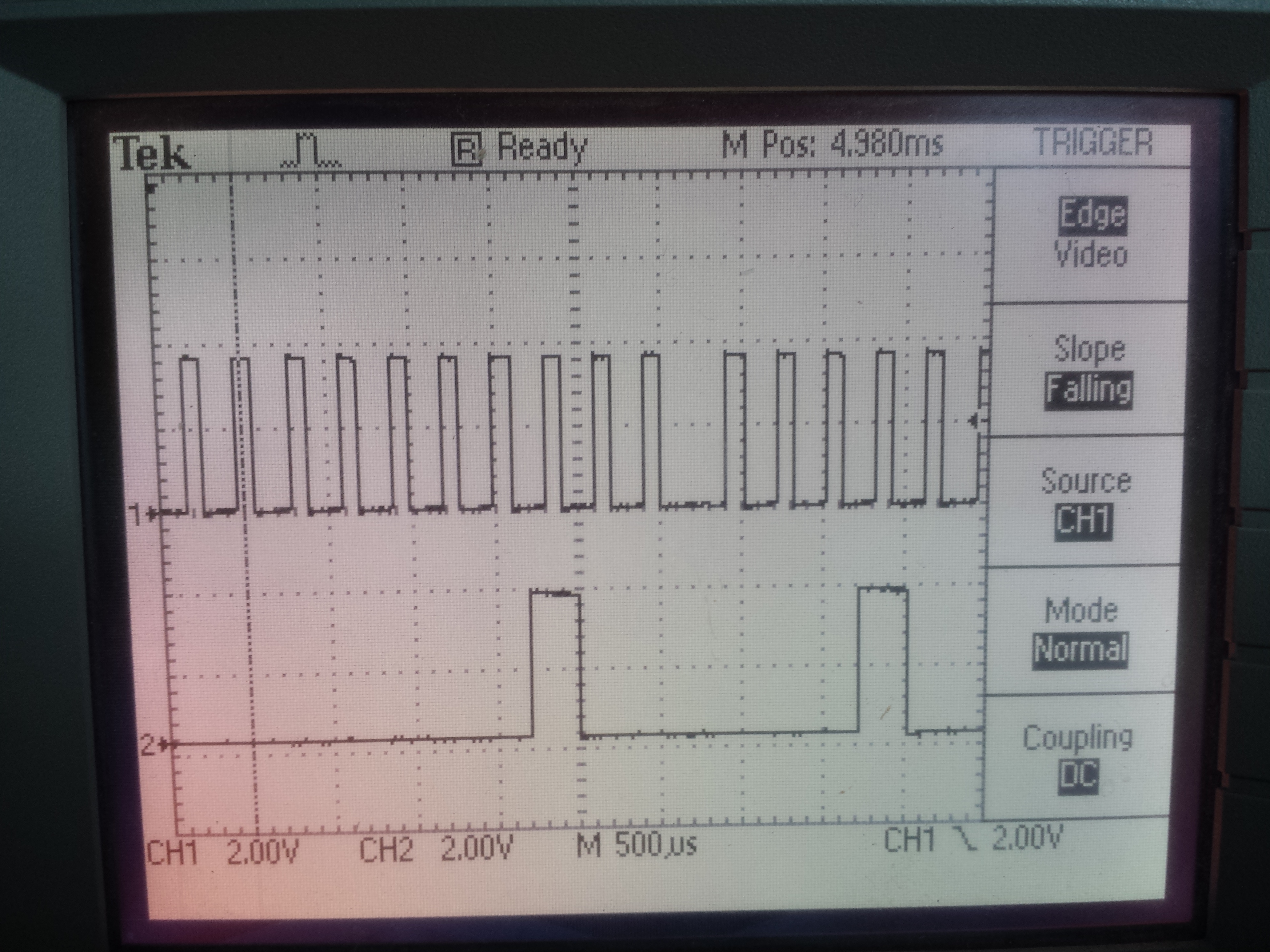

    Data read of both TLow bytes, followed by Master Stop
    The vertical cursor is on bit 1 of Frame 4, of figure 6, as found on page 11 of TMP275.pdf  (A0,A1,A2 = Vcc)
    So, why, is the upper nibble of the second byte of TLow set to "F"?

  • The reason  I was always reading FF for the second byte, is that there was a missing the required acknowledge by the Master to the slave between bytes read.  This needs to be sent from the Master to the slave between the 1st and 2nd half the of the Word you are reading.  Look closely to Fig 6, on page 11 of the TMP27 spec.  At the of second group of pulses, look for "ACK by Master".
