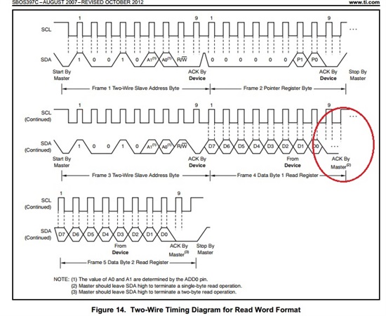

At page 14 of datasheet, Figure 14 shows "Two-Wire Timing Diagram for Read Word Format".
In the case of a two-byte read operation, should the master assert the ACK signal after 1Byte transfer (at (2) timing)?
I think that the ACK signal should only be asserted after 2Byte transfer completion (thus, at (3) timing).
Is my suggestion correct?
