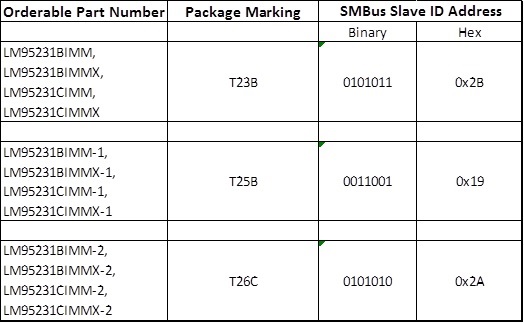

  • Hi Andrei,
    I’m sorry for all the confusion. TI acquired National Semiconductor several years ago, and after the merger they transferred the datasheet to TI format. There was typo on the SMBus slave ID address. Now, we have a new TI’s template format, and we don’t have any bandwidth to modify at this moment. However, I created the table for you below.
    Hope this helps!
    Aaron
  • Hi Aaron,
        Thanks for the quick reply. The table makes it clear and will also help others that may run into this issue.
    Andrei
