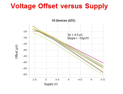

I'm working on a project using TMP006 to measure human skin temperature.
when I measure the temperature with the  tmp006evm  board, i get  a very different result from what i get with the component assembled  in my own board under the same conditions.
the value for temperature is  28, i receive with the tmp006evm  board registers via the GUI:
tdie = 0xE20
vobj = 0xFF35
and my own board shows
tdie = 0x102C
vobj = 0xFBCC
Note: the TMP006 sensor soldiered in rework machine for BGA IC's
the difference in the setup between the  tmp006evm  board and mo own board is :
1)  the power supply for the tmp006evm is 3.3V and my own board is 5V.
Can someone tell me the reason why it happened ?
Best Regards
Adel

  • Hello Adel,
    It's good to know that you have followed the recommended layout guidelines mentioned in the users guide document. Now to answer your previous question, Yes you will see a shift in the binary value equivalent of temperature when you increase the voltage from 3.3 to 5V. You will note that this will be a constant offset value across different temperatures for your 5V board compared to 3.3V EVM board. Hope I answered your query.
    Abhi
  • Hello Abhi
    Thank you for your response, it helps me a lot but it still doesn't solve the whole problems.
    I need to know how the supply voltage changes the device offset, can you provide me a conversion table or graph showing me the relationship between the voltage and offset value?
    In the case this table is available which is the dispersion from device to device?
    From the datasheets we see the voltage increase/decrease is about 7 ìV/°C , this is a typical value for TA = +25°C, V+ = 3.3 V,
    Is this value affected by supply voltage change? or in other words does the temperature amplifier gain also change with supply voltage?
    Adel

  • Hello Adel,
    Let me answer your questions.....
    Following graph graph does over the relation ship between offset voltage with respect to supply voltage. This graph is part of our characterization results for 10 parts. You can also observe the drift from part to part here.
    For every 1°C change in the temperature there will be 10uV change in sensor voltage.
    Dispersion from device to device increases upon increase in voltage from part to part. See graph above
    Its ~10uV/°C
    Is this value affected by supply voltage change?or in other words does the temperature amplifier gain also change with supply voltage?
    temperature amplifier gain does not change with supply voltage.
    I would like to know your intended application so I can better service your needs.
