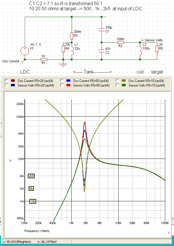

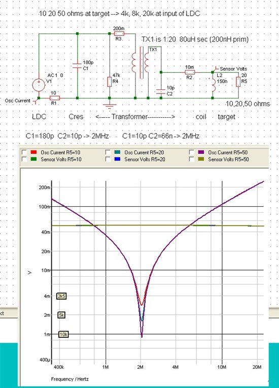

    I've run some sims , using "Simetrix".
    The tapped capacitor approach only works if you can tune the frequency of a larger tank to match that of  the sense coil and it's capacitor, which would be impractical if the sensor coil inductance changed with target position (and that's expected with this application)
    The transformer approach requires transformers with low parasitics ,  off the shelf current transformers are optimised for low inductance and low ESR and are likely candidates. So for example search for "current transformer" at your local vendor, and look for ratios of 20:1 or less and inductance ~ 100uH .  a typical 5mm sized current transformer might be 20:1 with 80uH on secondary (equiv to 200nH on primary) with a VT product of 10V.uS  (This transformer is perhaps a bit low on primary inductance, ideally the impedance of the transformer magnetising inductance would be ~ 5 to 10 times that of your load impedance, but difficult to get 10:1 ratio in standard HF pulse transformers)
    for example : http://au.mouser.com/Power/Transformers/Current-Transformers/_/N-8u9qq?P=1z0wrguZ1yzv4q7Z1z0wpemZ1z0wfk1
    The simulation results look like the following:
    So V1 is a  1v AC source, and R1 is a current sense, this represents the oscillator inside the LDC , it functions as a  GDO , so at the operating frequency of 2MHz, the current will be a minimum of 1mV across 10ohm , so Rp is simply 1v/100mV * 10ohm = 10k, I have tagged 10k, 5k, 2k5 for ease of reference.
    You resonant the circuit with C1 or C2 (or both) It's more practical to resonant on the secondary with 180p.
    TX1 , along with parasites R3 , R4, (and residual C1 or C2) is the transformer (R4 is a guess at the core loss, it will be temperature dependant, and a potential archilles heel)
    L2 is your 150nH coil with some parasitic R2 . It is connected to the single turn primary with (short) , thick, closely spaced tracks to minimise ESR and ESL.
    For the simulation, R5 , the "target",  is stepped at 10R, 20R and 50R , with the resultant theoretical values of Rp being 4k,8k,20k at the LDC,  from the dip curves we see that the "real" values of Rp are a bit lower , due to parasitic effects.
    For comparison I have simulated the capacitor tapped approach below: It is extremely sensitive to getting the L1 C1 tank resonated at the same frequency with the C2 L2 tank , and it's necessary to damp both tanks (by tweaking R4 and R2) to get an overlap. I have used 7:1 capacitor ratio for 50:1 impedance transform , and you can see the amount of change (i.e. the size of the dip) you get at the LDC is much less than the transformer approach.
    I would have to say the tapped C approach is probably impractical in this case.
    Hope this helps , BobT

    The only thing which I'd like to add is that one has to be careful with the transformer ratio. Transformer will multiply everything coming from that node! We suggest to choose the minimum ratio, at which the system starts working properly.
