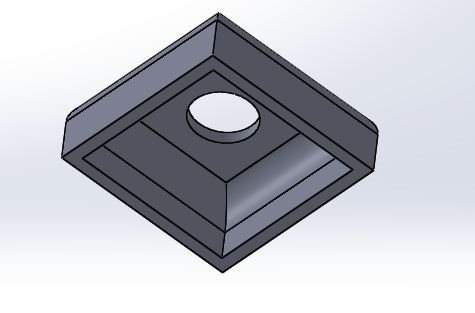

  • Greg,
       The small metal cans are not commercially available.  I designed some and had FotoFab make me some. The prototypes are flat and I have to bend them.  See the pictures below.  www.fotofab.com
       As for #2.  Keep in mind that you want to keep  any lid, tube, cover  as close to the die temp as possible so it does not become an ir emitter.  The shinnyer the better.  So we solder our lids to the ground plane that encompases our wcsp footprint.  Also keep in mind that any and I mean any field of view restriction gives you lower signal.  Which initially seems bad, but the quality of that lower signal is more of what you really want.  Also the fruther away from the device the target is the lower the signal will be. 2" will decrease your signal significatly.
    As for #3.  This is a good idea.  We have played with gold plating on the top side of the die and it definatly restricts the field of view.  The die are so small that i'd imagin it would be tough todo manually but if you have some type of micro screen printing operation, that might be a great solution.
    If you tell me more about your application I may be able to help.  Is it a commercial application?  Are you using the recommended footprint from the TMP006 users guide?
