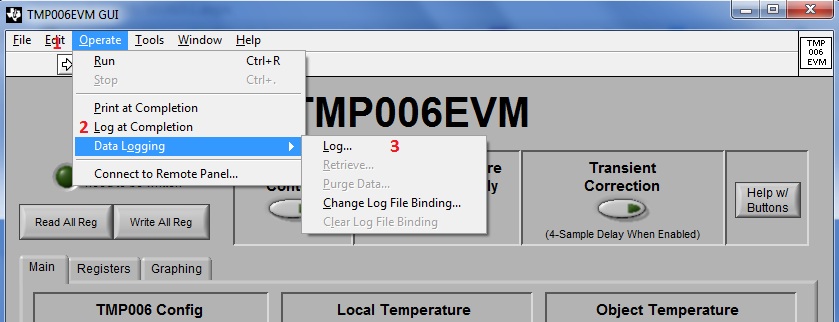

i am preethi i bought tmp006 breakout board for my project.. actually my problem is i dono how to retrieve the data from the non volatile memory in the tmp006 sensor. please help me out from this...

Hello Preethi,
Thanks for your interest in TMP006. I'm assuming you are talking about the TMP006 EVM. TMP006 does NOT have an internal non-volatile memory. However TMP006EVM GUI has options to log and retrieve your files to/from your computer.
You can do so by following the steps as shown in the picture below..
I hope you this helps with locating your saved files. Also, what's your intended target application with TMP006?
