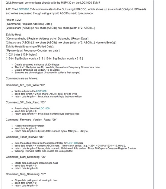

I am reading streamed blocks of data (1024 bytes Rp- 1024 bytes freq) from the ldc1000evm received after the "06" command.
The read rate seems to affect the results and there seem to be zeros popping in some times or perhaps it is a varying datastructure?
Any suggestions
