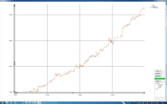

  • I am having the same problem. I am using the LDC1000 EVM and reading data directly (serial IO). All default settings as far as I can tell, but the EVM documentation is not clear on how chip settings are handled. As my slowly moving target approaches the coil the reading gets "stuck" at 10922 for a while and then continues. I am no seeing it jump ahead after this however; it just continues upward from 10922. My overall plot runs from about 10000 to 28000 and the part that is stuck at 10922 is about 5% of the total plot.
    Two clues about what is going on:
    1) In all other data blocks of 512 readings there is some variation from reading to reading. For the blocks that read 10922 there is not variation: it is really stuck.
    2) 10922 base10 is 10101010101010 in base2. Can this possibly be coincidental?
    Having spent a few days working with this device I now don't know if I can trust any of my readings. The rest of the curve looks generally correct but has a number of small odd features that repeat from test to test. Are these true measurements or artifacts of the sensor?
    Actually I don't know if the problem is with the LDC1000 or the programming on the EVM. I see that the previous post has not gotten a reply in over two weeks. This really needs to be addressed. Thanks for any light that can be shed on this problem.

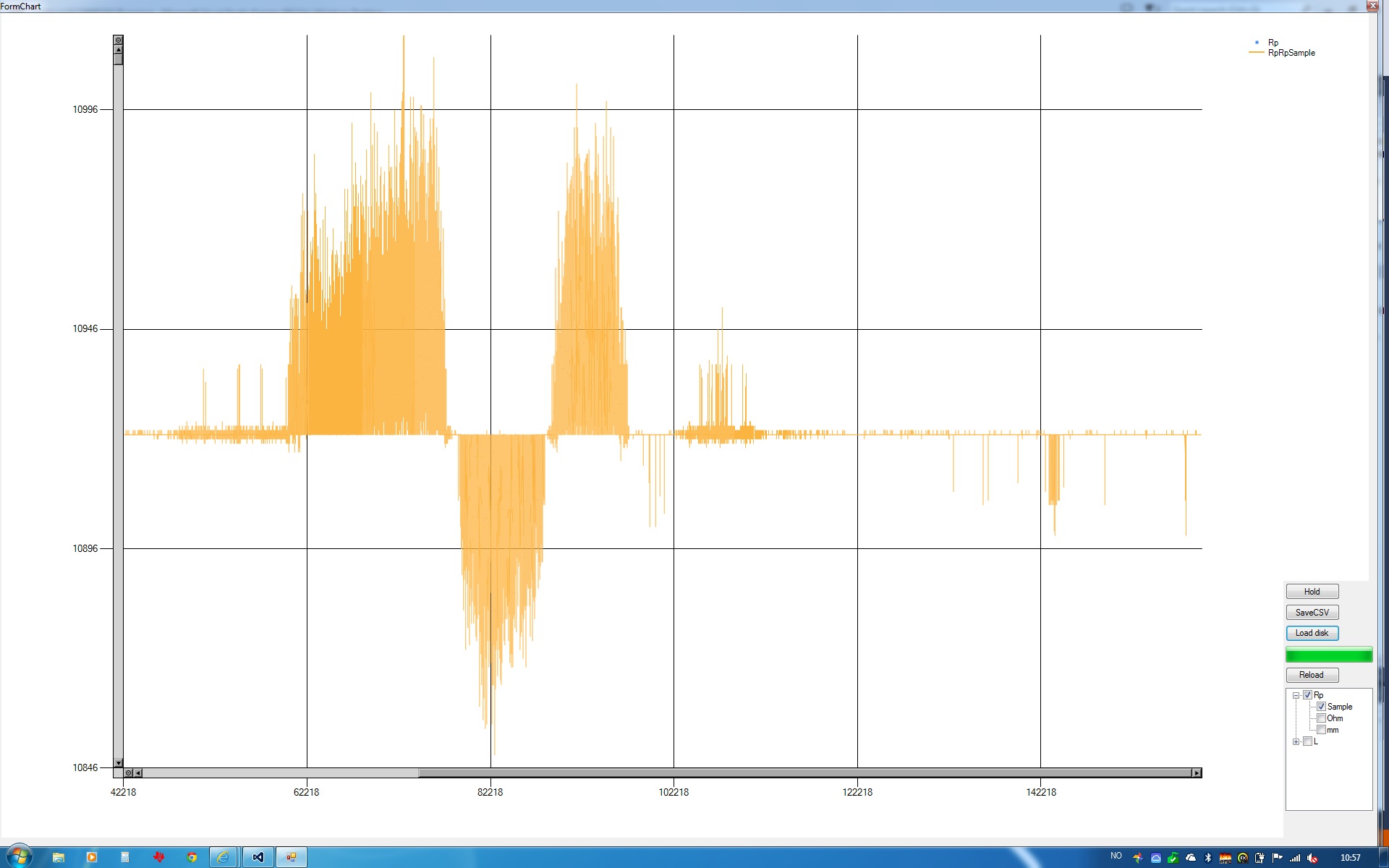

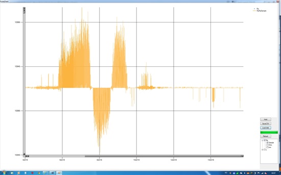

  • I can also se the 10922 artifact on my evm with standard coil. Here is an example graph. Just tried to hold the coil steady at 10922 and some wiggeling to get larger and smaler sample values.
    Settings
    0x01,0x13,,Byte,Rp_MAX
    0x02,0x3B,,Byte,Rp_MIN
    0x03,0xBE,0x94,Byte,Sensor Frequency
    0x04,0x15,0x17,Byte,LDC Configuration
    Regards Torgeir Skomedal

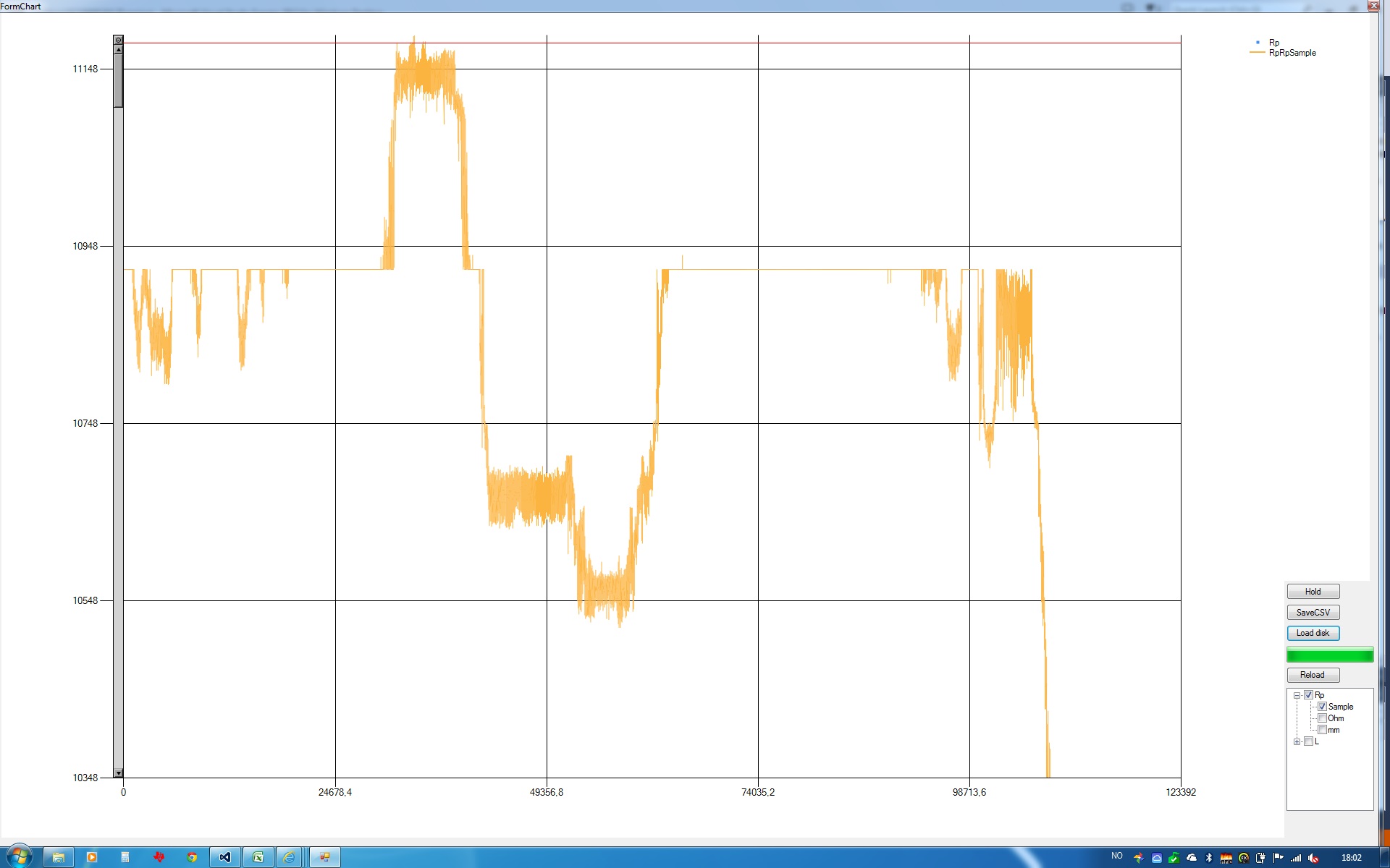

  • Could you reduce RpMAX setting by 1 or 2 codes (1-2 steps up in resistance) and see if it helps?
  • The same result with RpMax = 38785ohm
    I use 10k uC samplerate. Xaxis is sample number.
    0x01,0x11,,Byte,Rp_MAX
    Regards Torgeir
  • Hello Torgeir,
    There are two ways to fix it.
    1st, is to redesign the sensor (LC tank) to achieve higher Q value.
    If that is not possible, for the final application, when you have a well-defined range of motion, adjust Rp parameters so that 10922 is excluded from the useful range of Rp values.

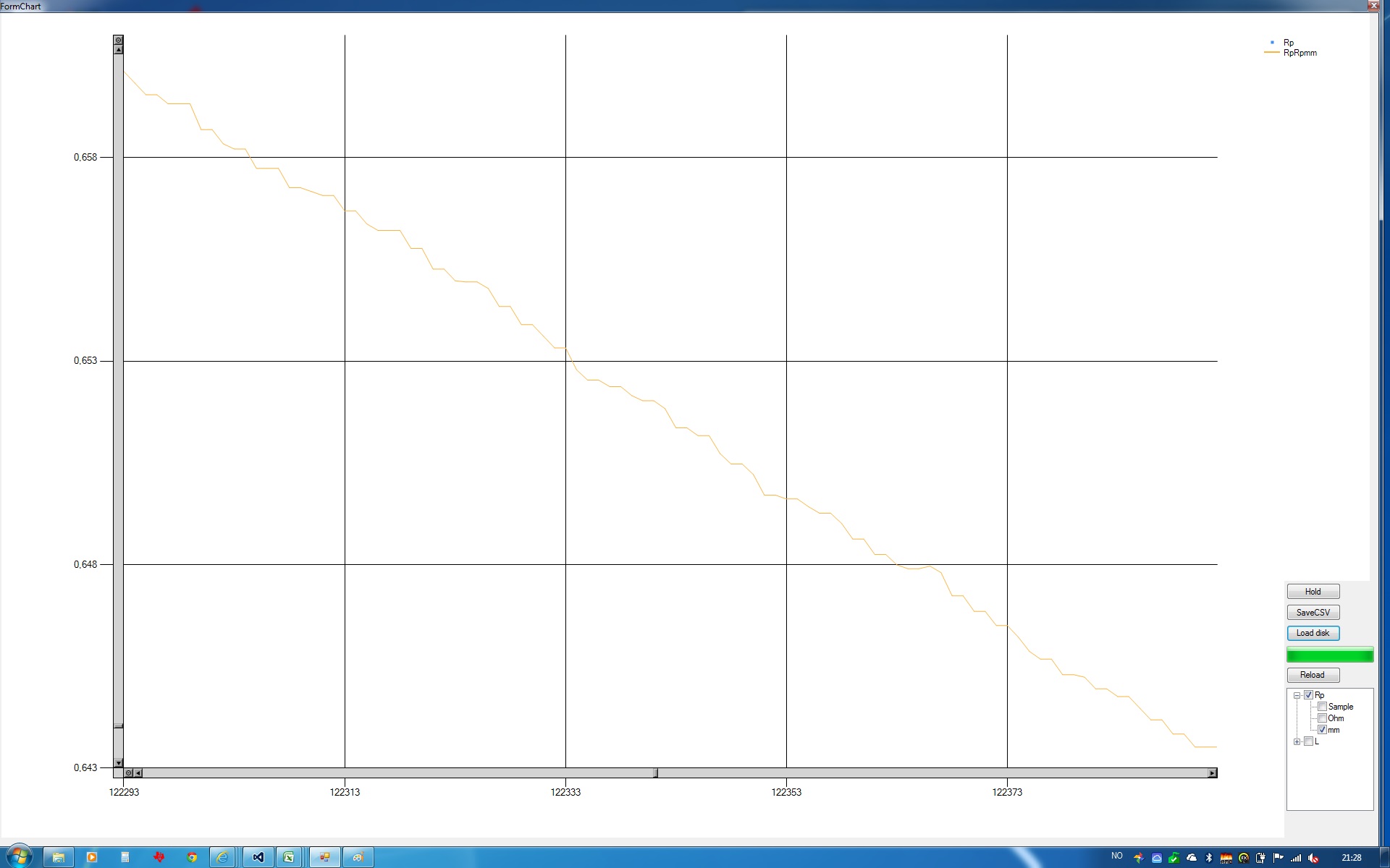

    It is also worth taking a look at inductance measurements - perhaps they give you enough resolution?
