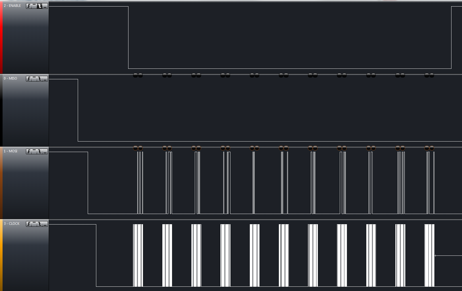

I am using a LDC1000 in a custom application (broke USB part from EVM apart, soldered connector) and have similar issues as readable in this thread: http://e2e.ti.com/support/data_converters/inductive-sensing/f/938/p/292151/1018937.aspx#1018937
Sadly the solution does not fit in my case. I made sure, I have VIO on 3V, the same digital supply voltage my STM32 gets. Also I can see all communication works fine except the SDO line (just stays on GND).
I supplied a 8MHz LDCKL and also tried a 2MHz clock.
Nothing changes.
Here is my init sequence:

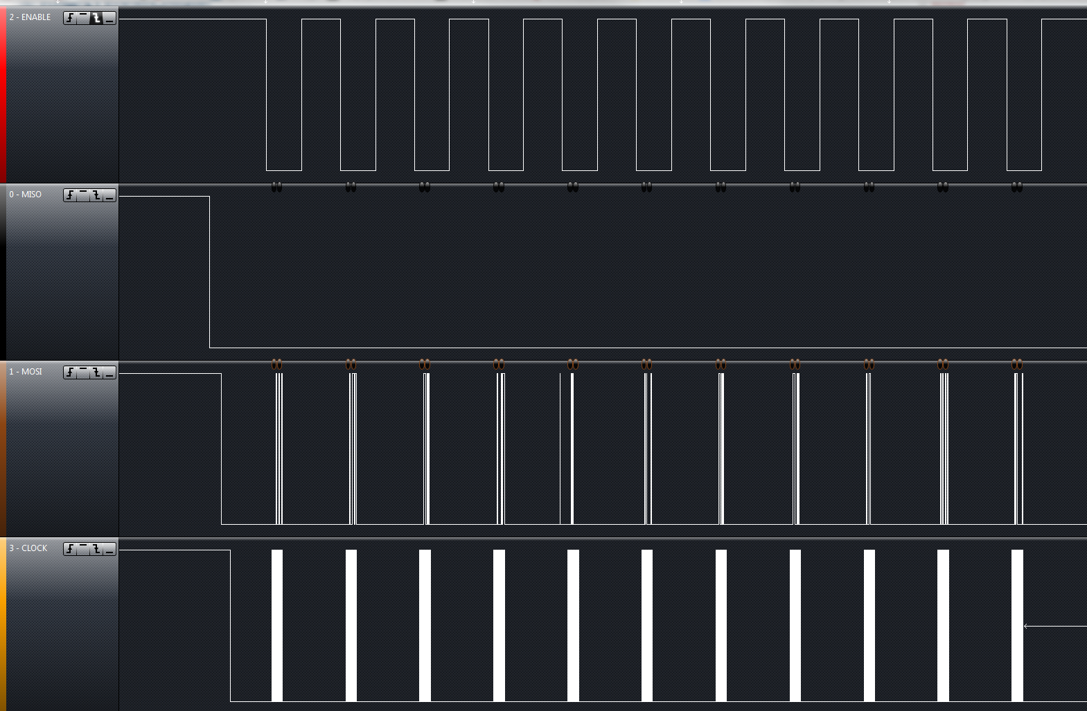

  • OK, I found out something.
    I had to change the init function in order to supply a valid start and stop condition around every single command.
    First off I had generated a start condition, supplied all my commands (init sequence) and generated a stop condition.
    I attached screenshots of the prior and after situations. Please forgive my I2C speak
  • Hi Stefan,
    One easy way to determine if your signals are correct is to connect your logic analyzer to the EVM, which outputs the correct signals.
    It seems to me that perhaps there is a misconfiguration of your microcontroller SPI registers.  I would validate that first to be sure that the microcontroller is not intentionally holding MISO low, and that the idle state of SCLK is high (it does not appear to be so).
    Next, I would validate that the rise and fall times are valid on a scope.
  • Hey Charles,
    thanks for your quick answer.
    Actually I got it running, when I just used the setup shown in the second picture.
    All lines idle state should be HIGH, right?
    I may have to tune on this, that's true. It looks strange.
    Rise and fall times seem to be in range, as I am able to gather valid output data.
