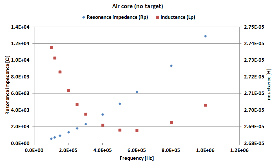

    a colleague helped me out today with a measurement of the coil with an analyser. This is the result:
    The analyser couldn't go beyond 1MHz. When I estimated the resonance frequency with a calculation I got 2.64*10^6 Ohm.
    Sietse

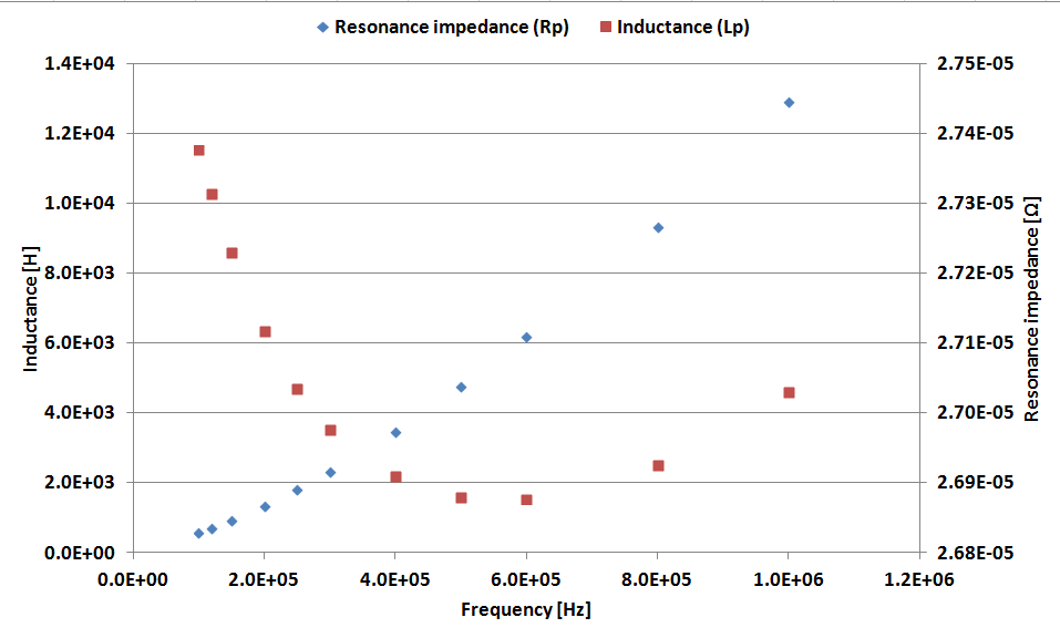

  • Ho sorry I've made a mistake. The axis are switched. It should be:
