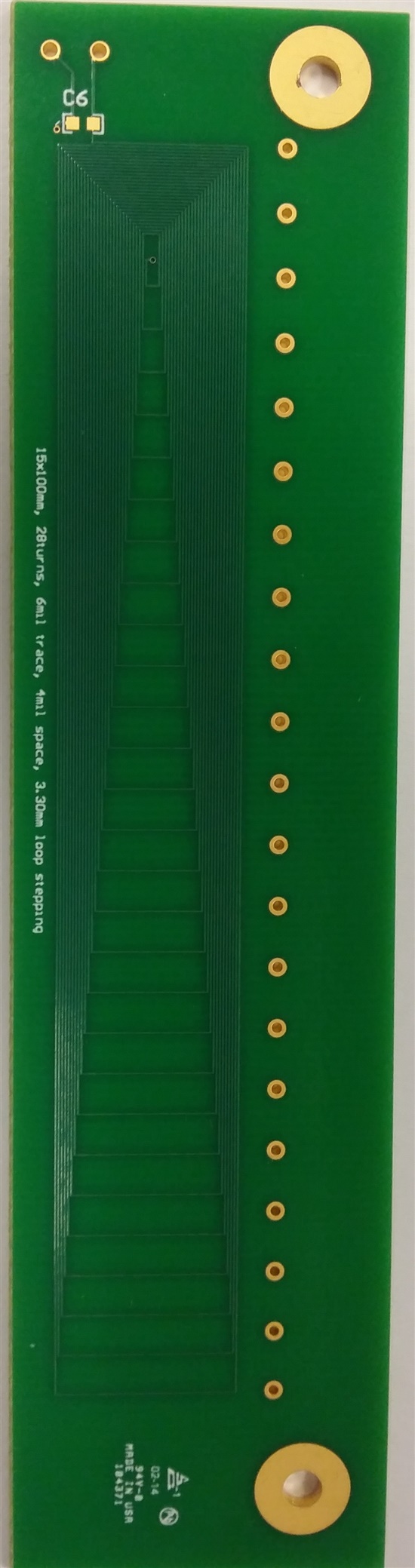

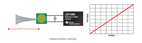

  3. Unlike the image below, would it be possible to have a uniform metallic float with a non-uniform coil to generate the same output

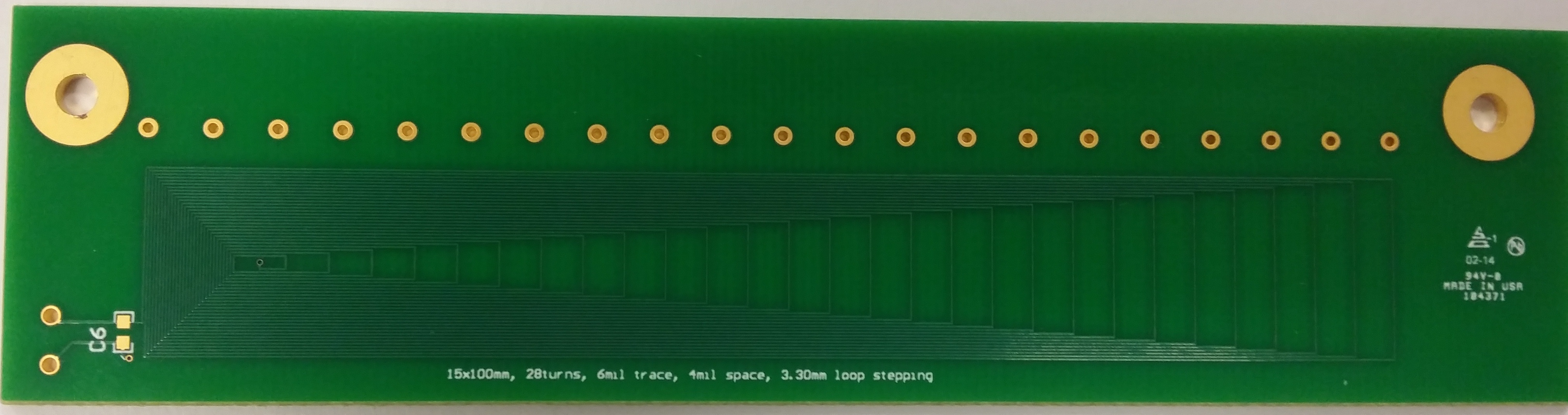

    "Unlike the image below, would it be possible to have a uniform metallic float with a non-uniform coil to generate the same output"
    Yes, you can lay out the coil to produce a non-homogeneous EM-field and use a uniform conductive target such as a rectangle. This image shows an example of a coil that produces a non-homogeneous EM-field which can be used for lateral position sensing of a rectangular target:
