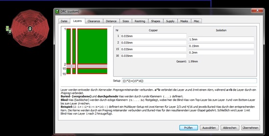

Webench LDC1000 Coil Layer Structure
I'm using Cad Soft Eagle v6.4 to work with my generated 4 layer coils from Webench LDC1000 tool.
When I open the downloaded .brd file I getting following layer structure.
Is this structure intended? that the isolation between first and second layer is so large dimensioned?
And all via's connecting layer 1 to 16?
Andy
