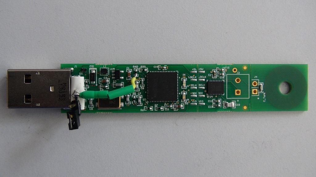

  • Hello Everybody,
    Yesterday I made some experiments about this topic so I'd like to share them hoping they could be useful for someone else and as a "request for comments" (or sort of).
    I tried to change the firmware of the LEDC1000EVM board with another firmware which does not use USB.
    Changing from the official to the personally developed one is quite easy because you can use the LDC1000EVM GUI. Going back to the official firmware is more difficult. First of all, as stated in slau319h on page 7, I need to put the microcontroller in bootstrap loader (BSL): owing to the lack of a button, I decided to have VBUS and PUR connectable with a jumper  and a 100ohm resistor as in the followin picture
    The value of the resistor has been decided after looking at figure 3 on page 11 of slaa425b.
    Then I could use the EVM GUI again but I prefer using the MSP430 Firmware Upgrade Example because of the messages that it prints on display seem clearer (but this is just a matter of taste). Independently of which GUI, I have to make the Firmware programming procedure run once with the jumper inserted to force a MASS ERASE executed by means of the BSL with the commands received from the GUI, then the GUI will fail to load to RAM a newer version of the BSL; just disconnect and riconnect the EVM this time with the jumper removed, it will go in BSL because the MSP430 will find an empty reset vector; wait it to be recognized by the program you have chosen then make the firmware upgrade procedure run again.
    It seems to me a little awkward so:
    1) Do I have to remove R40 from the board and provide another option in the jumper to keep PUR at GND? I think that the pull-up/pull-down ratio should make the presence of the jumper to VBUS irrelevant for DM but maybe I am wrong.
    2) Is that a problem of my EVM? Maybe another revision provides the facilty to send the microcontroller in BSL without whelding any jumper. I have LDC1000EVM SV600983-001 REV B.
    Gabriele
