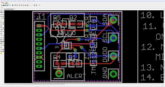

Is there any Eagle Library for TMP112 smd so I can make a PCB?

Hello Natalia,
I can point you to our EVM layout files that you can use as a refrence. These files are in Altium so let me check on it to see if you can open them with Eagle software. I will get back to you soon.

Hello Natalia,
Please see the attached files...
Thanks to Simon, for putting this together!
Abhi

Hi Natalia,
if all you wanted is to use the part in Eagle you can download the ".bxl" file from our website
http://www.ti.com/product/TMP112/quality
And use the free software "Ultra Librarian" (link also in the webpage above) to convert it to any program you need.
I did this for you and attached the Eagle library file ".lbr" for the TMP112 to this post.
Hope this helped!
