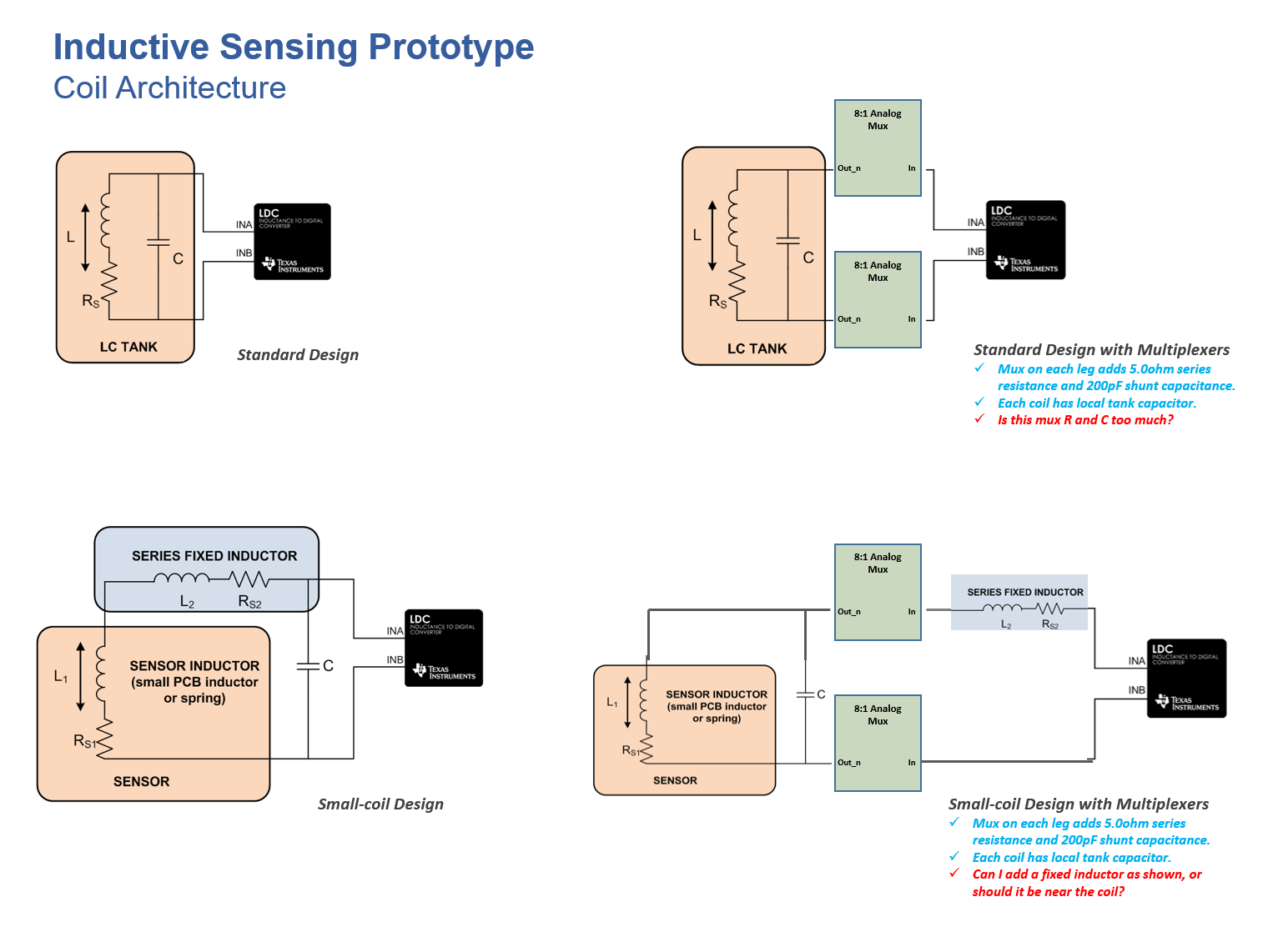

We have a need for very small sensing coils in a design, and I found the "How to use a 2mm PCB Inductor as a Sensor" very helpful.
Can you please clarify where the additional fixed inductor should go if we are using multiplexers in the coil path. Ideally we would like to use a single fixed inductor on the LDC1000 side of the muxes.
Thank you,
