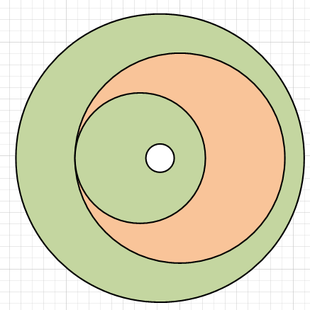

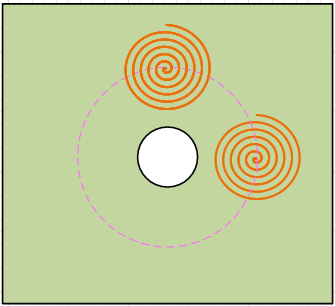

I have a customer who is using the LDC1000 in a linear sensing application. They would like to use it in a rotary application. Currently, they have a triangle to measure linear displacement, but a rotary may be more deterministic.
Is there  an example of how to make the rotary wheel – as if you were going to measure motor movement?

    For a full rotation, 2 or more coils are needed. A good implementation using 2 coils with 90 degrees apart on a sensor board, as shown below:
    We then have a rotating target for the sensor to detect. A good target shape (where the orange is copper) is:

    It is important to maintain a fixed separation. To determine the angle, measure the response of the two coils and use the Arctangent function to determine the angle.
