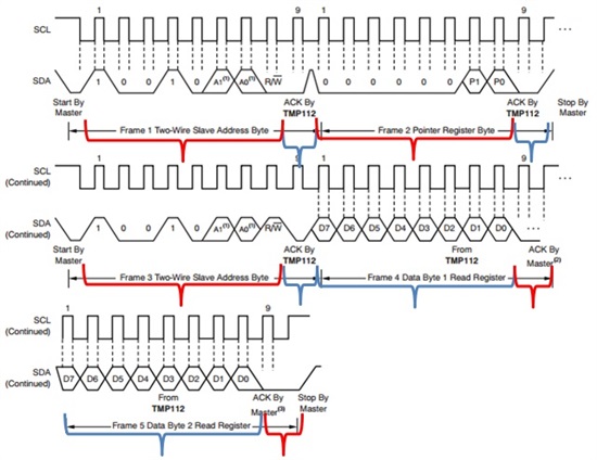

  • Hello Natailia,
    It looks like TMP112 does not acknowledge the host device. Unless the TMP112 acknowledges to the I2C slave address sent by the host you will not be able to access the temperature registers.
    Please make sure your waveform matches the above diagram. The best way to go about is by hooking up SCL and SDA lines to a an oscilloscope. Notice that marked Red is what you send via host processor and blue is what you need to expect from the TMP112. Also please don't forget the start and stop conditions specified in the above picture.
