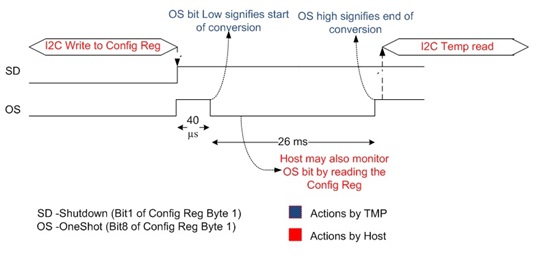

  • Thanks for your quick response. We are currently using your TMP112 on several products and on a very, very rare occasion  (1 in a million+ and not repeatable), the TMP112 conversion did not end. I issue a one-shot conversion command and put my processor to sleep for about 500 msec to conserve battery. At the end of the 500 msec nap, I check the OS bit being set before reading the temperature data. In that particular device the OS bit remained low.  What I wanted to do, if this issue happens again, is to issue a general reset to the TMP112, wait a few milliseconds and start another one-shot conversion as quickly as I can.  I was not sure how long I have to wait  from general reset before issuing another one-shot conversion. Do you have another suggestion on what I should do if the OS bit gets stuck?

  • The TMP112 is running at 4Hz (default). When I issue a one-shot conversion command, I set byte 1 of the configuration register to "0xE1" and byte 2 to "0xA0". I then check for the OS bit to be set before reading the temperature data. I did not get any I2C error and the OS bit was "low" which indicated that the conversion started so I am assuming that the device received the command correctly. I still have not resolve this issue because I cannot reproduce the problem so I am looking for explanations or other ideas to prevent this from happening. I will send you the schematic. Thanks for your reply.

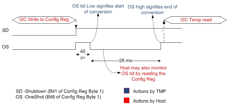

  • Hello Bobby,
    500ms is ample amount of time for the device to recover even in case if there was an issue. Its very strange that the device dosent recover for about 30seconds+2.5seconds. Unless we replicate the issue I really dont see a way to get to the bottom of this.
    Above  picture is for your reference.
