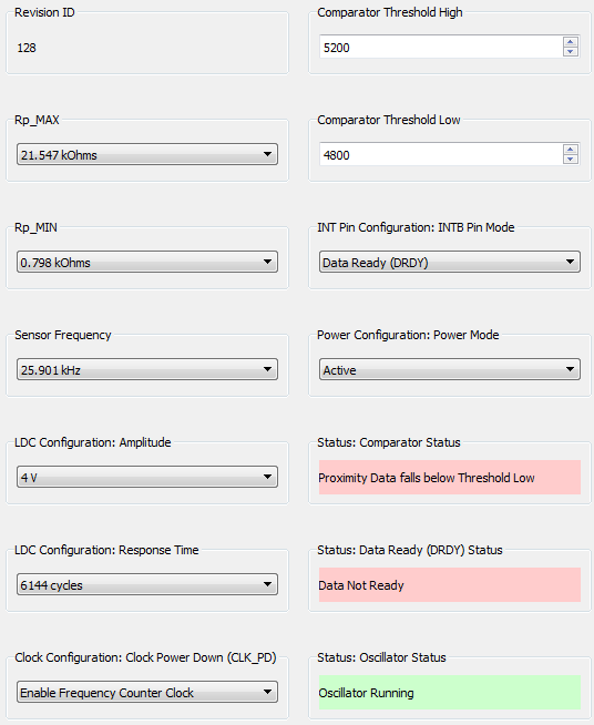

  • Hello Ben,
    Here are the screen captures from the GUI:
    The configuration settings:
    With best regards,
    Joris.
  • Hi Joris,
    did you set the filter capacitor correctly (refer to LDC1000 datasheet section 'Choosing Filter Capacitor (CFA and CFB Pins')? A wrong filter capacitor value could cause noise on Rp but not on L.
