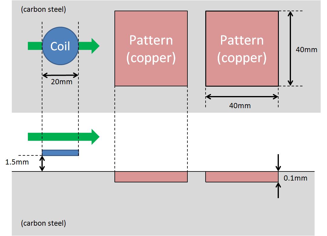

My customer want to detect pistons of cylinders by LDC1000.
In concretely, the pattern of cylinders is detected by the sensor of coils.
I attach the figure of the condition.
The detecting point is from beginning lap of coil and pattern to completing lap.
Could you give me advice about designing of sensor(ex. coil turns)?
Please let me know lack of information.

  • Hello Kuramochi-san,
    Your diagram looks good. However, I would need more information to assist.
    I assume you are planning to use L measurement only. What is the desired oscillating frequency of the sensor? How many PCB layers are you planning to use?
    The oscillating frequency of the sensor is determined by the following formula: f = 1/(2*PI*SQRT(L*C)). The range is 5kHz- 5MHz, described by the D/S. All I would worry about here is to stay away from the existing frequencies in the system (for example, if you have another signal at 1MHz nearby you would not want to operate at 1MHz).
    Here is what I would recommend regarding the number of the turns in the coil: the more turns you have, the larger the inductance will be. Since the diameter is only 20mm, you want to use as many turns  as you can. Your limiting factor here is determinted by the price of PCB manufacturning. Thus, I would advise your customer to do as many turn as possible in his pricerange.
    Let me give you an example for your geometry: with 4milx4mil (spacing between traces and width of trace), 2 layers, and 6 turns per layer you get ~ 5.437 uH of inductance. 5uH inductance is border line sufficient to satisfy LDC1000 constrains (f sensor range and Rp range).  If you can have more turns, your inductance will go up, which gives you more freedom of selecting the capacitor. We generally recommend >5uH inductance (please note that it is possible to add a descrete inductor in series, but the % change will be minimized then).

  • Kuramochi - san,
    4x4 mil refers to the width trace and space between traces of the coil. These specs you enter in Altium when you are designing the coils. The PCB coil on LDC1000EVM uses 4x4 mil specs. You can choose otherwise - I just gave you an example.
    You need to stay in the range of 2 parameters for LDC1000: Fsensor and Rp. Low inductance wont have enough parrallel resistance; thats why you need at least 5uH regardless of the test conditions.

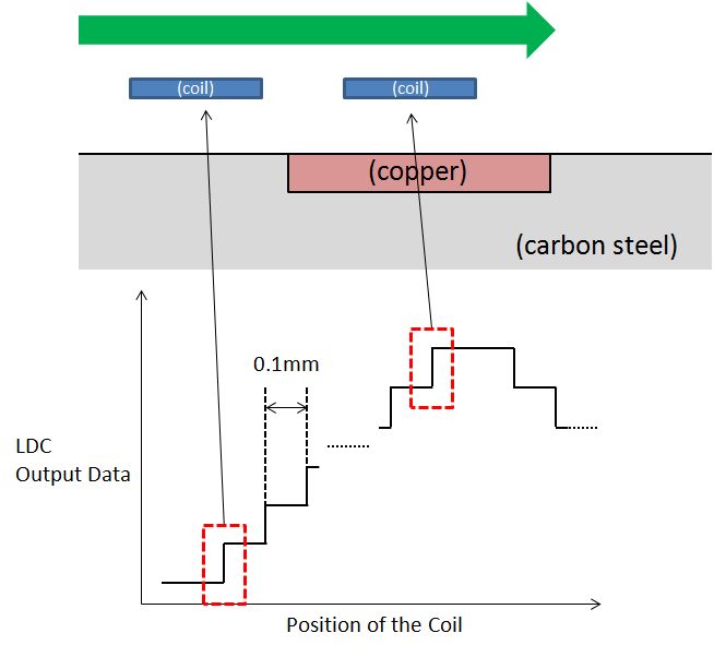

  • Natallia-san,
    Thank you for your information.
    I understood them.
    My customer needs the resolution of ±0.1mm and linerity ±0.1mm.
    Please refer the following diagram.
    The oscillating frequency of sensor is about 100kHz.
    How should we think about the optimum inductance or number of the turns in the coil?
    Again, that would depend on your fabrication constains. At 4x4 mils and 20 mm diameter, you could usea  2 layer board with 12 turns per layer as I described above. With12 turns, the total inductance would be ~19uH. Since the operating frequency is 100kHz, you would need a 133317 pF (133nF) capacitor in parallel.

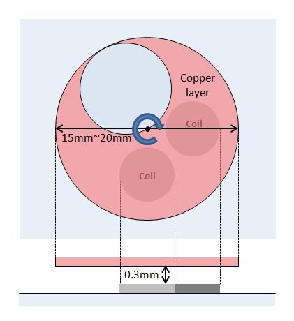

    I ask you the other case.
    I hope to detect angle of a rotator and to get the sin-wave(and cos-wave).
    I am thinking the following pattern for this condition.
    If you have the better idea of the pattern, please let me know.
    Happy New Year to you too! Your design looks good. Regarding the LDC1000 ENOB, there would not be a straight answer since the ENOB will depend on mechanics of the system, target material composition, etc.
