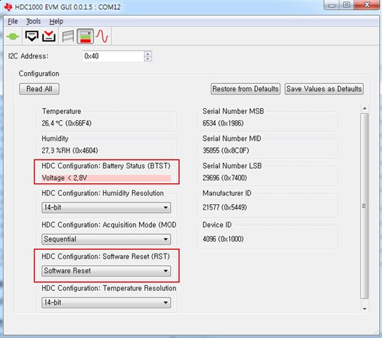

I'm reviewing the GUI of HDC1000 EVM.
I found the bellow problem.

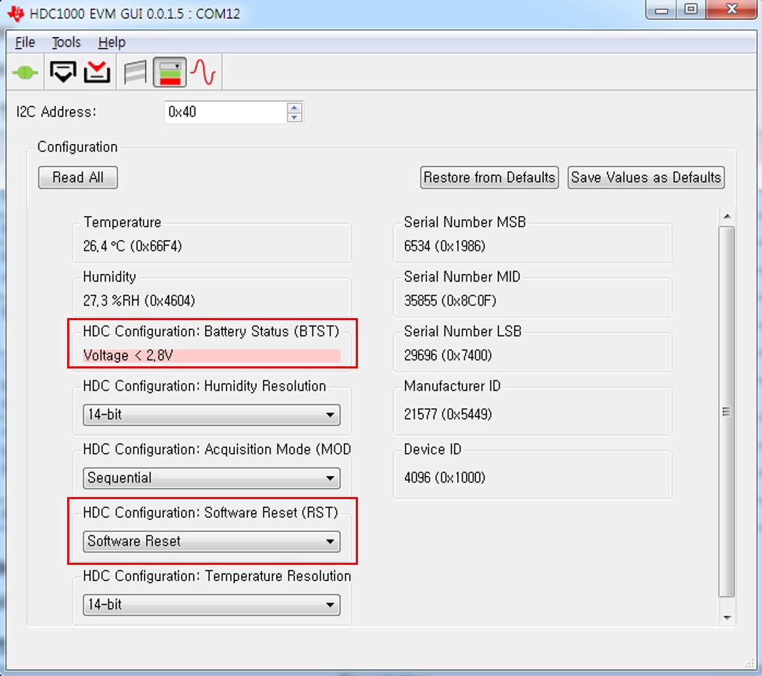

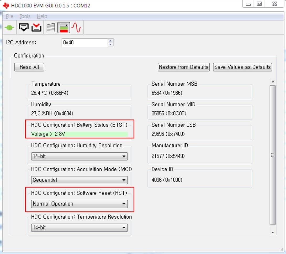

If Software Reset is selected in HDC Configuration, Battery Status is changed "Voltage > 2.8V" to "Voltage < 2.8V".
I can not understand why Battery Status is changed.
I think that the register value of HDC Configuration has to be changed "0x1000" to "0x9000".
I want to know why.
Please refer to the bellow pictures.
- When Software Reset is selected
- When Normal Operation is selected
Thanks.
  • Hi Chung,
    when you issue a software reset, the behaviour of the HDC1000 is very similar to the startup.
    The info on the battery status needs to be re-evaluated by the HDC1000 and it happens only after a request of measurement of RH or Temp.
    See the section of the DS related to the Voltage supply monitor,
    regards,
