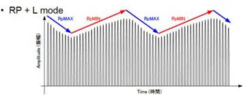

Hello TI Community,
is there any additional information what RP_min and RP_max do change inside of the LDC1000.
N1: I noticed that drift seems to by high if a small Rp_min is selected.
N2: Some RP_min and RP_max combinations seem to suffer from higher noise than others.
N3: The results of RP do often strongly depend on the selected Rp-Range. How can i get trustworthy results of Rp-range to use for calibration.
In addition:
N4: If my smallest rp-range settings are(for example) 16k and 21k. If i lower RP_min step by step it clips of at 4k even if the range got larger and my RP measurement should  be in range. What is happening there internally?
