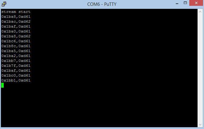

    After writing a register it is required to read back 32 bytes – MCU response to a command. Convert ASCII string into array of 8-bit numbers. It consists of the command sent + 21 bytes of 00 + CRC value. In the above example, correct response is 4C 15 01 00 04 2A 1B 82 0D A3 00 00 00 00 00 00 00 00 00 00 00 00 00 00 00 00 00 00 00 00 00A3.
    4th byte (indicated in red above) is an error field. If this byte is 00, there is no error.
    Read register command
    Read register command is used to check LDC register settings. Read process consists of 2 steps:
    1)      Set register command, which is required to indicate which register is to be read. The command format is: 4C 15 01 00 02 2A XX ZZ, where XX is the register address to be read, and ZZ is CRC-8 check for the command string. For example, to read back register 1B the command is 4C 15 01 00 02 2A 1B 10. After sending this command it is required to read 32 bytes. The 4th byte will indicate an error, if any.
    2)      Read register command, in the format 4C 14 01 00 02 2A 02 ZZ, where ZZ is CRC-8 check. After sending this command it is required to read 32 bytes, as noted above. The 4th byte will indicate an error, if any. 7th and 8th bytes are MSB and LSB bytes of the register value. For example, if we read register x1B value, the response is 4C 14 01 00 03 2A 82 0D C6 A3 00 00 00 00 00 00 00 00 00 00 00 00 00 00 00 00 00 00 00 00 00 C6
    Start streaming command
    To optimize data throughput a special command is implemented, which will continuously output data from LDC devices to COM port.
    To start streaming, send 4C 05 01 00 06 01 29 04 04 30 2A C1. After sending this command it is required to read 32 bytes. 4th byte will indicate an error, if any.
    After the stream is initialized, read 32 bytes at a time. An example read:
    4C30 0100 092A 0151 42CB 0150 5FFF 1C00 0000 0000 0000 0000 0000 0000 0000 001C
    Bytes 7-10 are the Ch0 data (marked in green), MSB 1st, bytes 11-14 are Ch1 data (marked in blue), MSB 1st. In this example, Ch0 data is x015142CB (22,102,731 in decimal), Ch1 is 01505FFF (22,044,671). Further conversion of the raw data to the frequency of oscillation is described in the LDC161x/131x datasheet
    Stop streaming command
    To stop the streaming, send the command 4C 06 01 00 01 01 D2. After sending this command it is required to read 32 bytes. 4th byte will indicate an error, if any.

  • I just found solution by myself: I need hex string instead of ASCII:
    serial_port.write('\x4C\x15\x01\x00\x04\x2A\x1B\x82\x0D\xA3')
  • Hi All,
    Please see below short Pyhon script to read write LDC1614 registers.
