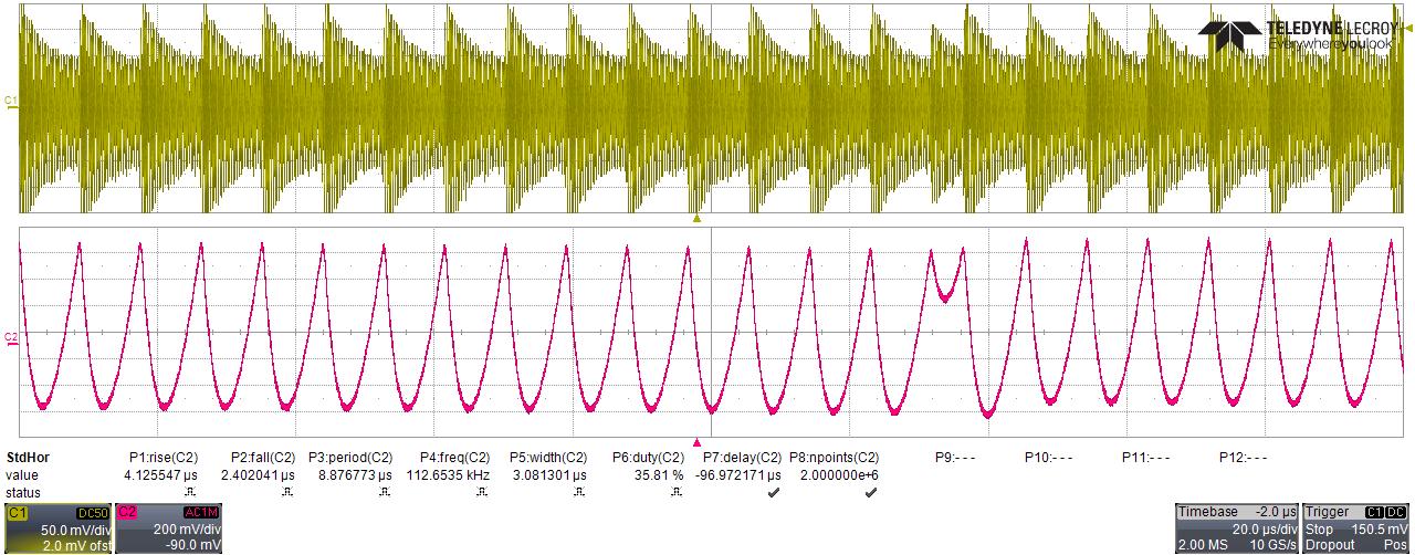

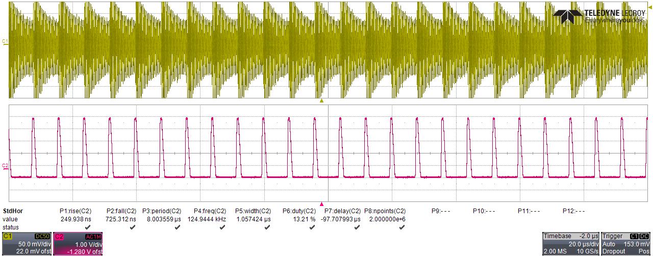

1. Filter Capacitor=20pF(stock), air-coil
CH1: current in the LC-tank
CH2: voltage on the CFB-Pin
As you can see the measured voltage on CFB-pin is not steady. The Rp-value is not steady either(+-30). I tried to vary the values of Rpmax and Rpmin but it didn't help. The peak-peak-voltage is higher than the desired 1V so I tried another value for the Filter Capacitor.
2. Filter Capacitor=33pF, air-coil
Now I’m closer to the desired 1Vpp at CFB-pin but this time it looks even worse. The Rp-value is very unstable (+-50).
3. No Filter Capacitor, air-coil
What I tried next is to remove the Filter Capacitor at all.
Now the voltage on the CFB-Pin is clipping(5Vpp). This time the Rp value is very stable(+-1).
It seems that removing the filter capacitor can lead to a smaller tolerance of Rp.
One problem: The small tolerance of +-1 is not true for all of my metal targets, but it’s not that bad.
In your datasheet you say that the voltage on CFB-pin should not exceed 1Vpp but my impression is that it gets better if the voltage is clipping at 5Vpp. Did I overlook any difficulties or is there a better way to stabilize Rp measurement? Could you please give me deeper info on the LDC internals so I can understand the purpose of the filter capacitor?

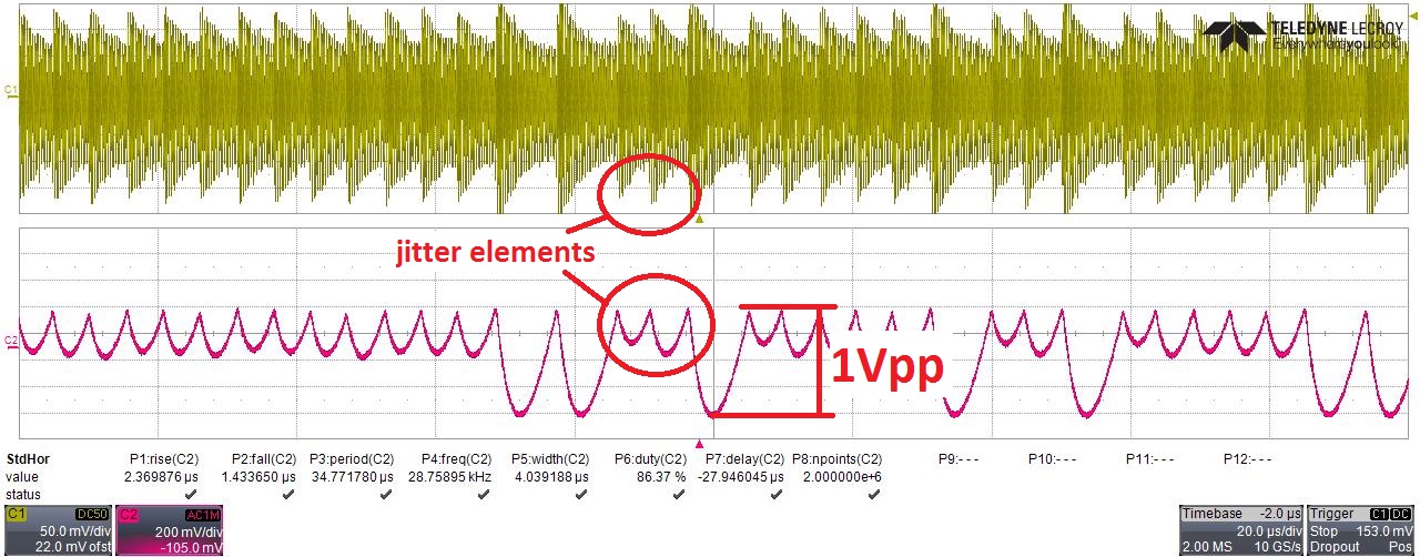

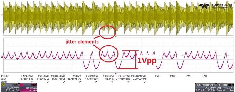

    I can’t really imagine the function of the filter capacitor yet. Which time can I set with it? Do you have any idea why the voltage on the cfb-pin has these “jitter-elements” in it even if I set the voltage to 1Vpp? I think that these “jitter elements” are the reason why the measurement is unstable.

    I tried this, but the jitter is still there. I also tried it at 500kHz with higher capacitor values ... still jittering.
    Is there a way to get rid of this jitter or do I have to live with it?
    Dieter
  • Dieter,
    The shape of the waveform on Cfb pin is not as important as the amplitude. Also, please check your Rp values.
