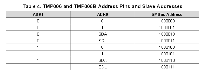

    Per section "8.3.8.1 Serial Bus Address" in the TMP006 data sheet, the A0 and A1 pins of the device must be hooked to power, ground, SDA or SCL. Table 4 shows the resultant addresses for communication.

  • Nithin,
    I don't know what addr is in your code.  Does it follow the table below?
    If you still can't get the part to respond, please start probing your SCL and SDA lines and see what is working and what is not.  Send us screenshots of the working and not-working captures, and we can debug further.  I cannot say if it is software or hardware without knowing what the hardware is doing.
