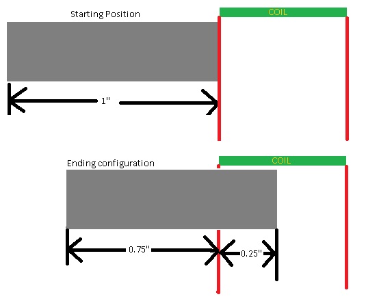

I am attempting to design a coil to measure changes in linear position.  In order to do this I am going to position the rack (part of a rack and pinon system on a EM actuator) approximately 1mm away from the sensor coil and move the rack perpendicular to the coil such that increasingly larger portions of the rack move under the coil as shown below:
Will this setup diminish the accuracy in any way?  I understand the measurement will be non-linear with this type of configuration but that is easily adjusted for in SW.  I will be using a coil with the following parameters:

Using these parameters I get a skin depth of 0.03 mm is that correct?  If so does that mean that the coil can only sense 3xskin depth into any particular metal?  What is the coils maximum sensing distance? (i.e. if I put a piece of conductive metal 3mm away from the coil would the sensor see it?  How much of an effect would that have on the reading?)
Is this coil design optimum for the type of application that I am using it for?  If the above application is trying to sense the rack but there is other metal on the side reverse of the rack that we don't want to sense is there a way to design the coil to not sense that metal?  Would it be better to shield the coil from the other metal using some ferrite material?

  • Hello Kyle,
    Your design looks good. The maximum sensing distance is 1/2 of the coil diameter if the target is exactly parallel to it. Shielding the coil with ferrite is a good idea if you have other metals present nearby. Skin depth is a function of the metal. You can think of it as a Gaussian distribution. For example, if the thickness of the metal target is 3 skin depth, the magnetic field will be able to penetrate 99.7% of it (or 3 sigmas). In your case, since you are exposing a small portion of metal, the distribution will change. However, the distance between the coil and the metal is 1mm (which is very good), so I believe you will see significant changes in LDC reading.
