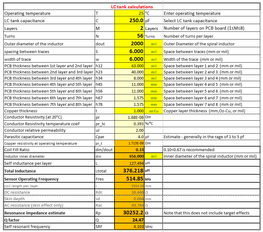

I am planning to design a prototype coil to evaluate LDC 1614. The requirements are as follows:
sensor frequency: 500 kHz
sensing distance: 1 inch
outer diameter of coil: 2 inch
inner diameter of coil: 2/3 inch
2 layer pcb 6 x 6 mils (trace and spacing)
capacitor : ?
number of turns: ?
and how can i design a footprint of a circular coil? does orcad have any tool to design one?
I appreciate if someone can suggest me cap value, number of turns, tool to design and any other parameter (if I forgot). I planning to design two or three different coils to evaluate performance. so, help me decide 3 different coil designs so that the distance vs inductance is as linear as possible.
