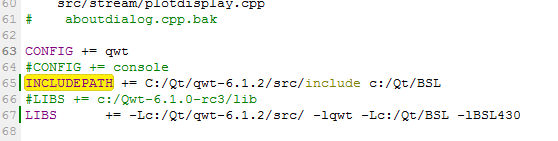

  • Hi Blair,
    Thank you for the detailed answer.
    I followed the steps, but wanted after building the qwt library I didn't find lib directory so I changed the .pro of the fdc1004 gui to the /src directory as the image below. Hence, I didn't succeed to compile it yet, is there a link to compiled library of qwt or what am I missing?
    Thanks again,
    Itamar
  • Hi Itamar,
    Qwt may have compiled outside of the source directory. For example, my Qwt compiled to a directory next to the source directory called "build-qwt-Desktop_Qt_5_4_1_MinGW_32bit-Release". That folder contained the "lib" directory with the dll and lib files.
    Also, I believe your INCLUDEPATH for Qwt is incorrect. At least with my Qwt source there isn't an include folder. I suspect you should have "C:/Qt/qwt-6.1.2/src".
    Blair

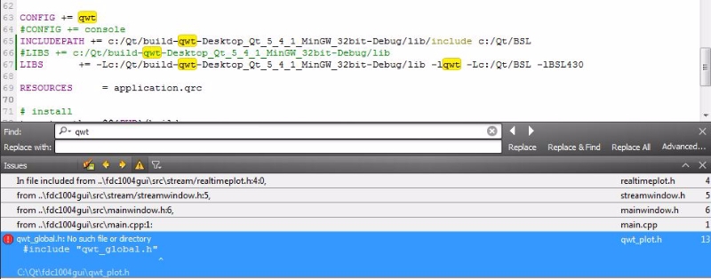

  •  Hi Blair
    Thakns, it indeed was built outside and I changed the path accordingly. The strange thing is that the gui project wasn't built since qwt_plot.h was not found although I changed the paths. it was not found in realtimeplot.h (from fdc 1004 gui project) so I copied qwt_plot.h to the same location and after that the error was that qwt_global.h is not found, please see below screen shot.
    What do you think is missing?
    Itamar
  • Hi Itamar,
    The INCLUEPATH and LIBS path will not be the same. Leave your libs path as you have it and adjust the Qwt portion of the INCLUDEPATH to "C:/Qt/qwt-6.1.2/src". If you look in that directory you should find the include files there.
    Blair
