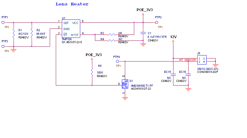

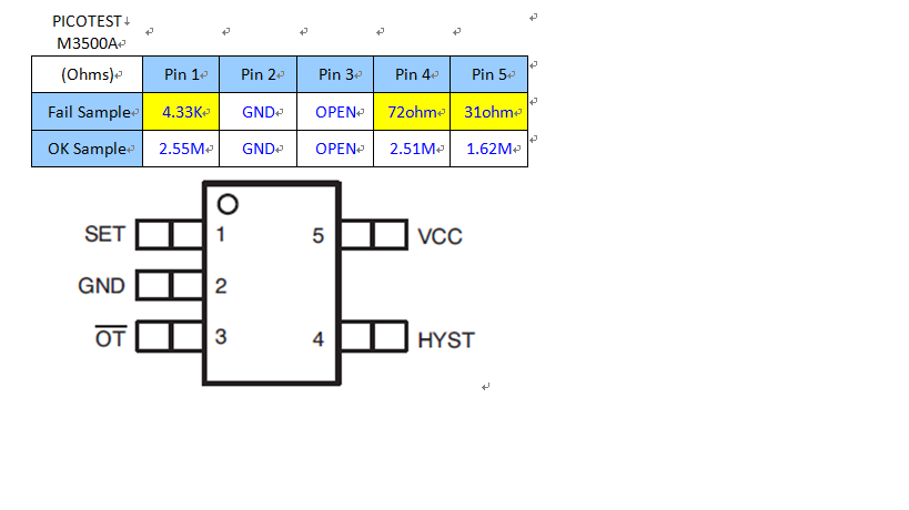

  • Hello Jason,
                      it is pin 4 and pin 5 short and damage after EOS. Please refer to below schematics. Do you have any comments for it? Thank you.
    BR
    Patrick
  • Patrick,
