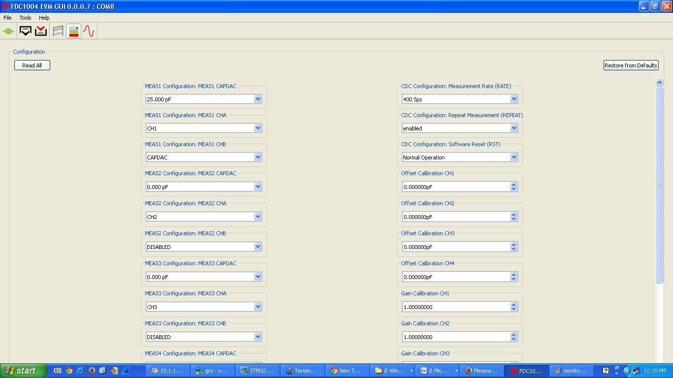

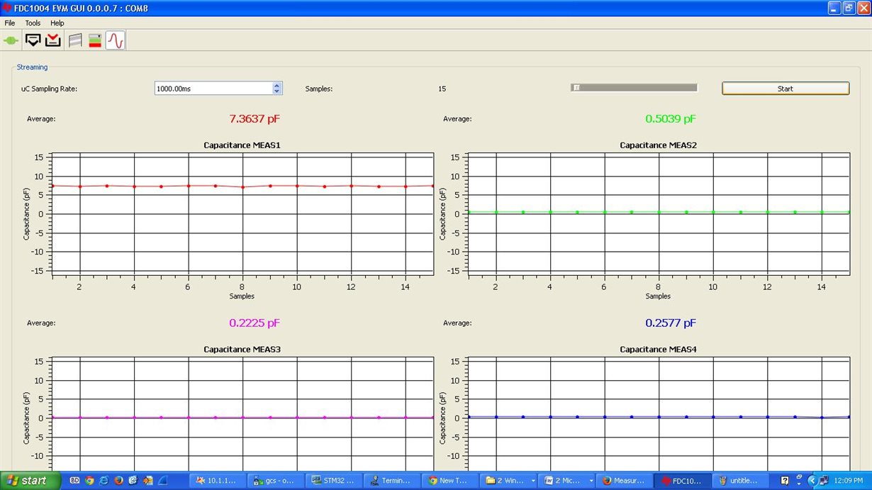

I am trying to make proto board to measure the diesel level through cylindrical sensor using FDC1004 eval board,
I have connected the cylindrical sensor sensing electrode to the FDC 1004CIN1 , Ground electrode to FDC1004 GND and cable shield to the FDC1004 SHLD1 pin (used in between sensor and FDC1004 chip)
Our sensor capacitance range is 183 pF to 167 pF for full and empty diesel levels ,
I want to measure the same through FDC1004 Eval board,
Anyone can guide me how to configure the GUI tool to measure the sensor level capacitance of 183pF to 167pF.
