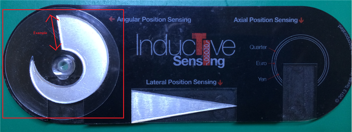

Please let me know about measure of LDC1000 Evaluation Kit. (attached below)
Customer want to see measure of rotation sensor unit.
Is there an application note of this kit?
Satoshi
Hello Satoshi,
LDC1614/LDC1314 is more suitable for rotational sensing as it has multiple channels. If LDC1000 is used for this application, then mulitple LDC1000 devices need to be sychronized for rotational measurement.
The below reference design provides complete information about rotational sensing:
http://www.ti.com/tool/tida-00508
-Best Regards,
