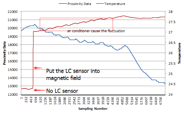

Why do the outputs of LDC1000 take a long time to be stable? What factors cause this result? Emergent question, Thanks!

I have put a LC sensor into the magnificated field generated by the LC circut connected to LDC1000. And the output of LDC1000 is as the picture, the proximity data increased until to a stable data. I have tried several times, all results are the same. I don't know how to explain the result and what cause the phenomenon.
If it is related to LDC1000, Hope someone can help me, Thanks.

  • Not two LDC1000, there's  two LC circuits, one from the LDC1000EVM connected to LDC1000 directly, the other one is made by myself.
    Right, I put one next to the other, and coupling distance is a constant. And result shows that after putting one to another, It takes a long time
    to be almost a stable value. So, is it related to LDC1000? How to explain the phenomenon?
    PS: the long time is about 4~6 hours.

    The LC tank is just a signle LC oscillator, it connects nothing.
    Actually, what we think is to change the C to be a capacitive sensor, it can be a temperature sensor, a pressure sensor or some other capacitive sensor.
    but the result what we test is not so stable when the C is just a capacitor(as the figure shows). So, we don't know if the phenomenon is related to the performance of LDC1000, or it is ourselves faults.

  • So, if LC tank is not connected to anything, why do you have it there at all?
    Yes, you could utilize LDC to measure changing capacitance.
    As you mentioned, it will be sensitive to temperature variations, and perhaps this is what you observe in your experiments, as you run the AC
