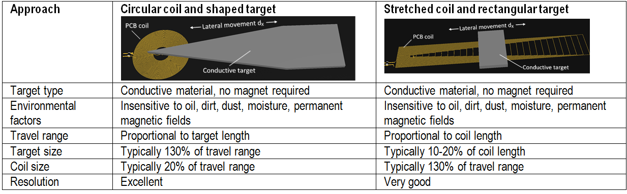

I was reading Ben's blog on linear positioning. Can you share your target design? It looks like it was done in Altium which would be perfect for my application.
I'm thinking of trying this in an industrial application and the equipment is made of aluminum. If I create the target on a FR4 PCB and the circular sensor on FR4 PCB do you think I'll still be able to get good results or will the data be "corrupted" by the exposure and close proximity to all of the metal of the equipment?
