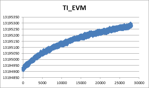

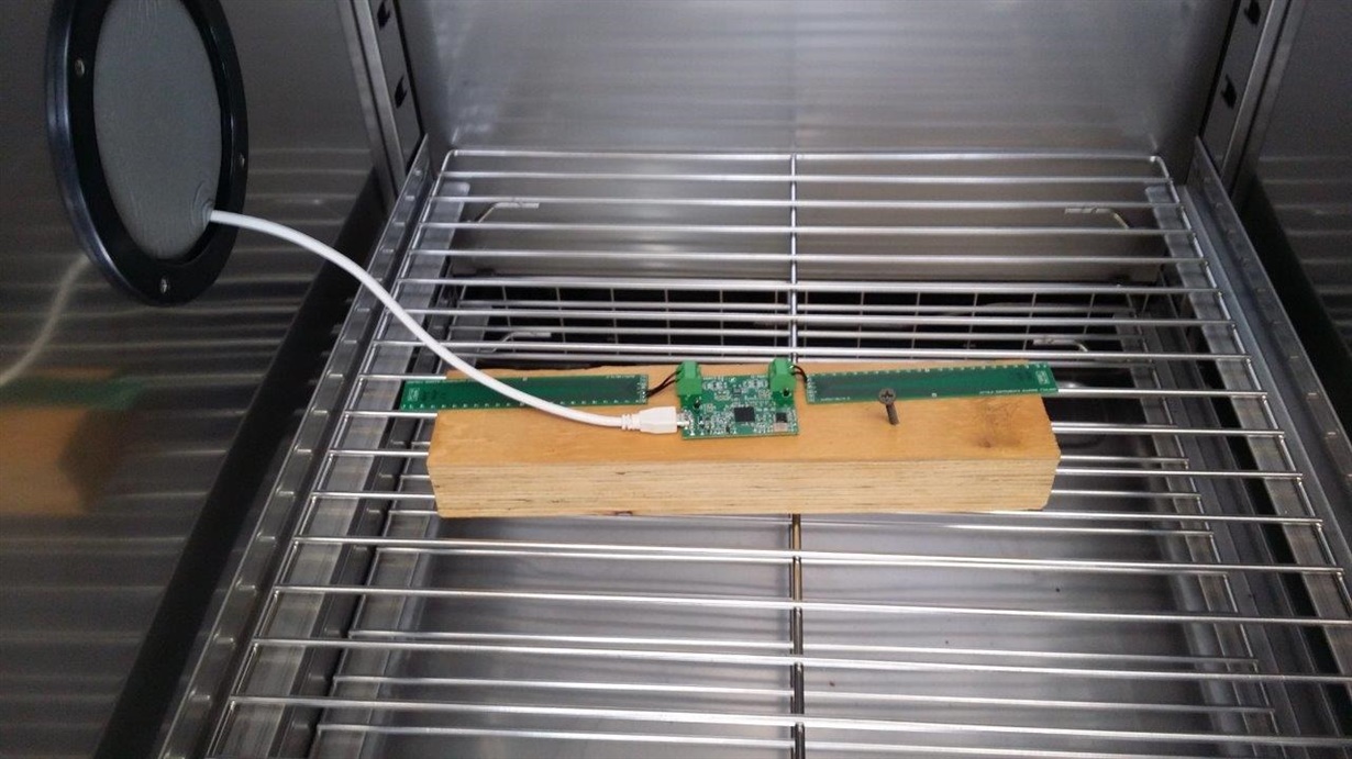

We have noticed that our rectangular 2-sided coils show a considerable drift that might be due to temperature. The drift can be order of thousands of units in couple of hours. In order to investigate this further we put the LDC1612EVM board with two coils into a oven. The temperature was 30C and we used our own coil as well as the circular coil that came with EVM. We assumed that the signal should be effectively a horizontal line with gaussian noise at least in the TI's coil, instead we got similar drift in both coils (see below). This is bit worrying as we use LDC1612 in linear position sensing and if the DC offsets in static temperature the product is unusable. The measurements below were made in period of 16 hours.
We also noticed that there is a transient during the first couple of minutes when the coil adjusts to the external temperature. After that the actual drift starts. Are we doing something very wrong with the measurement parameters. The electronics used in this test was the LDC1612 EVM.
    For the TI_EVm the code change is ~400, the signal is 13,195,100. This corresponds to 0.00003, or 0.003% or 30ppm change.
    How important is this miniscule change for your application?
    For your reference, C0G caps are specified at 30ppm change per degree C, so a small temp change may indeed have caused this drift.

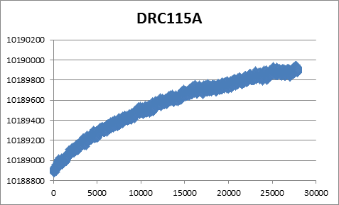

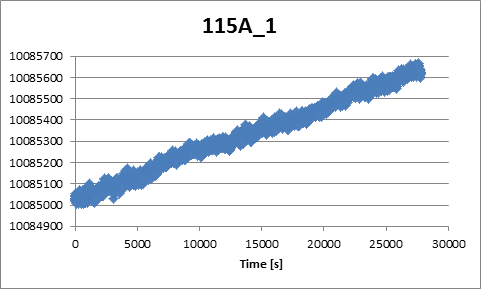

  • The problem is that with AVX NP0 capacitor (100 pF 1%) the drift in our own coil in 8 hours is about 65ppm (see below). This happens in static temperature in oven. We see somewhat similar behavior with the TI's own coil. The question is that if there is a constant drift with 800 units/8 hours and our system is up and running for 90 days are the results anymore usable in linear position sensing.
  • Could there be some other factors? How was the coil supported?

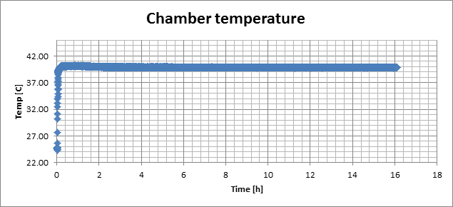

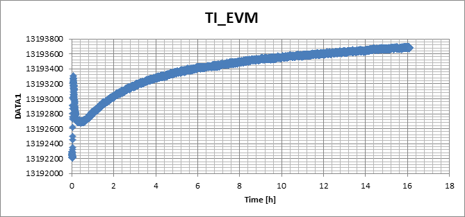

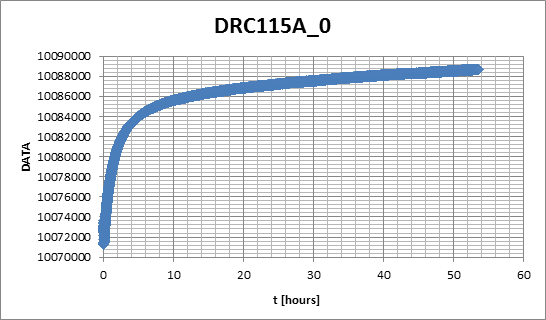

  • We did another measurement during the weekend. The initial temperature in the oven was 24 C and it was increased to 40 C. Below is a picture of the setup and the measurement results. After 10 h the oven is definitely in static temperature but the signal still shows a considerable drift. We are now doing the same test with the LDC1612 sample coil that came with the EVM. Could LDC measurement parameters affect the drift?

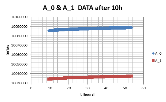

  • We remade the oven experiments, this time with our own coil and with TI's sample coil. We also put a precision thermometer into the oven. As can be seen from the figures the oven holds the static temperature pretty well. There might be a slight drift of about 0.1C but when compared to how the LDC1612 behaves this isn't enough to explain the drift. The LDC1612 coil and/or circuit drifts about 50 ppm for this 0.1C drift! I really, really would like to know what goes on in here.
    Is it possible to repeat this experiment with glass support instead of wood? I'd be very interested to see the results.

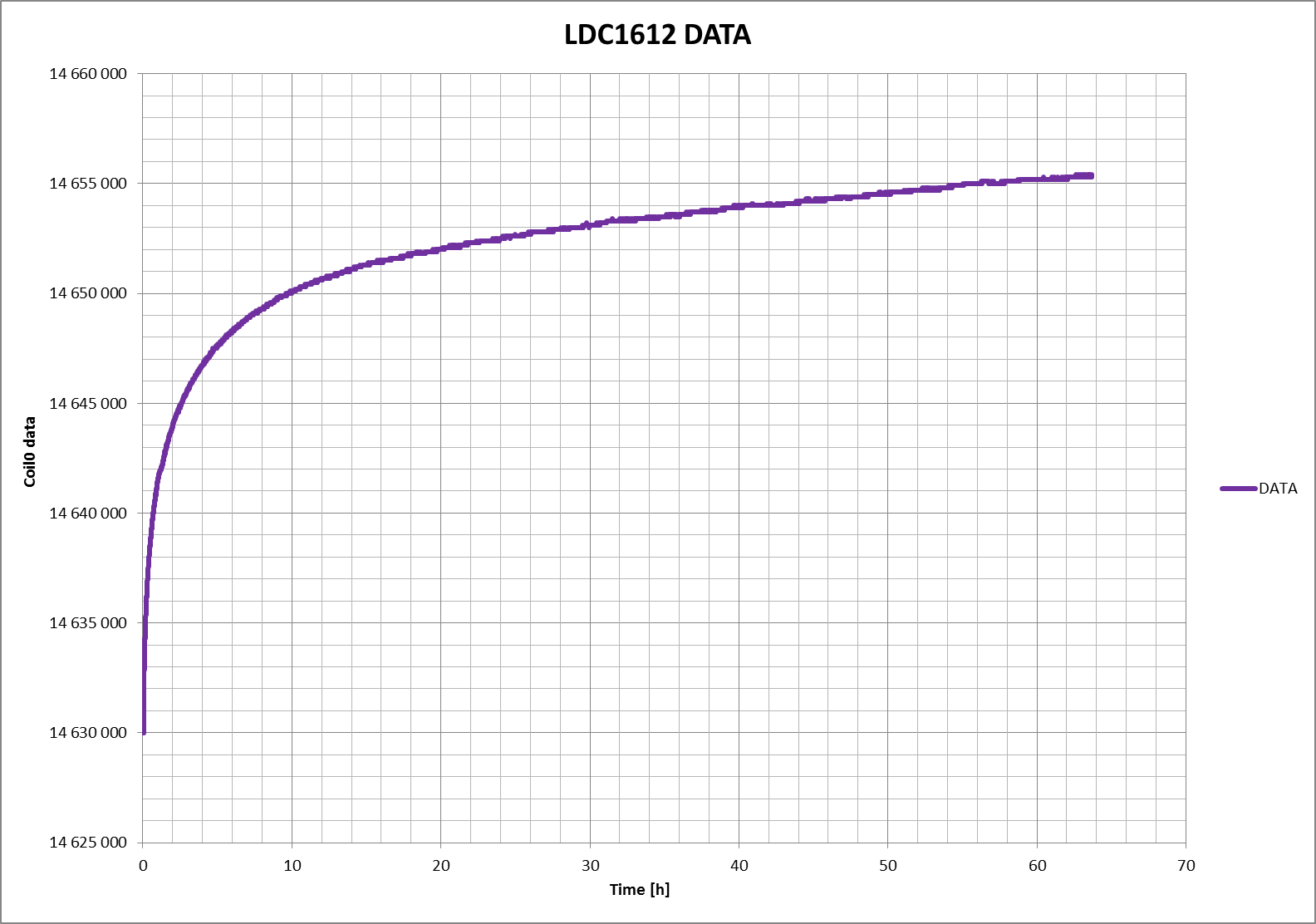

    I've repeated a test similar to the one shown in Sami's post using a keralite substrate.
    I am using a rectangular coil rigidly attached to the substrate, and to our own PCB design utilizing LDC1612.
    The system is placed in a temperature chamber driving constant 30 degC starting from a ~25 degC at Time 0 hours.
    Chamber temperature settles typically in some tens of minutes, max some hours.
    Here is how the data looks like:
    I am interested of this drift phenomenon, because we are targeting to a system with DR between 10 000 to 100 000 data units of the LDC161x.
    What I would like to know is, that
    • Could this drift happen due some potential bad settings of the LDC1612 in our SW?
      • Are there some specific settings, which we should carefully review?
    • Do you recommend using the LDC1612 in always on configuration, or should it do periodic wake-up from sleep/shutdown to gain more accuracy?
      • Could the drift continue forever (or until the output saturates) in the always on use-case?
    • Do you have other concerns regarding the test setup, which could cause the drift? Environment temperature is constant.
      Thank You for your support!

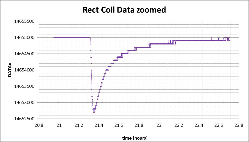

  • Hello user4341326, Igor,
    While there is no mechanism in LDC1612 to drift with time (and only time!), it's important to understand on the system level, what is changing in the system to cause the drift.
    I would also monitor the xtal reference frequency and oscillation amplitude as a function of time. Drying of the PCB (and consecutive change of geometries) is also a major suspect, but it's difficult to measure accurately.
    We were thinking about this drift, and came up with a couple of experiments. Is it possible for you to run them and post the results?

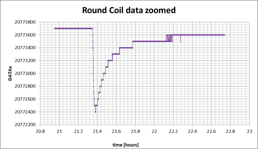

    1) Run the experiment for a few hours, then open the door of the chamber, leave it open for a few seconds, then close again. Post results of full run, and zoomed-in version on door-open event, and door-close event. Or just post an xls with time stamps
    2) Run the experiment with the door open, but blocked with a piece of plastic/wood
  • Hi Evgeny, all
    Thank you for the suggestions & advice!
    Effectively, we don’t know yet what in our prototype system causes this drift. Today we can’t completely disregard the clocking path, or other system level errors yet. The sensor – PCB coil + NP0/C0G Cap – however, is considered “clearly” as the most inaccurate part of the system, and the assumption is that we are essentially measuring the behavior of the sensor. As the time constants, which we are observing in the temperature behavior of the system, are so long (data doesn’t settle in 50-60 hours in stable environment) I became slightly worried about that are we really measuring the sensor thermal behavior.

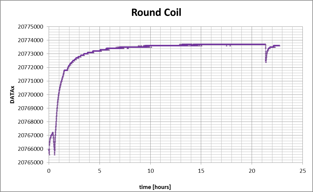

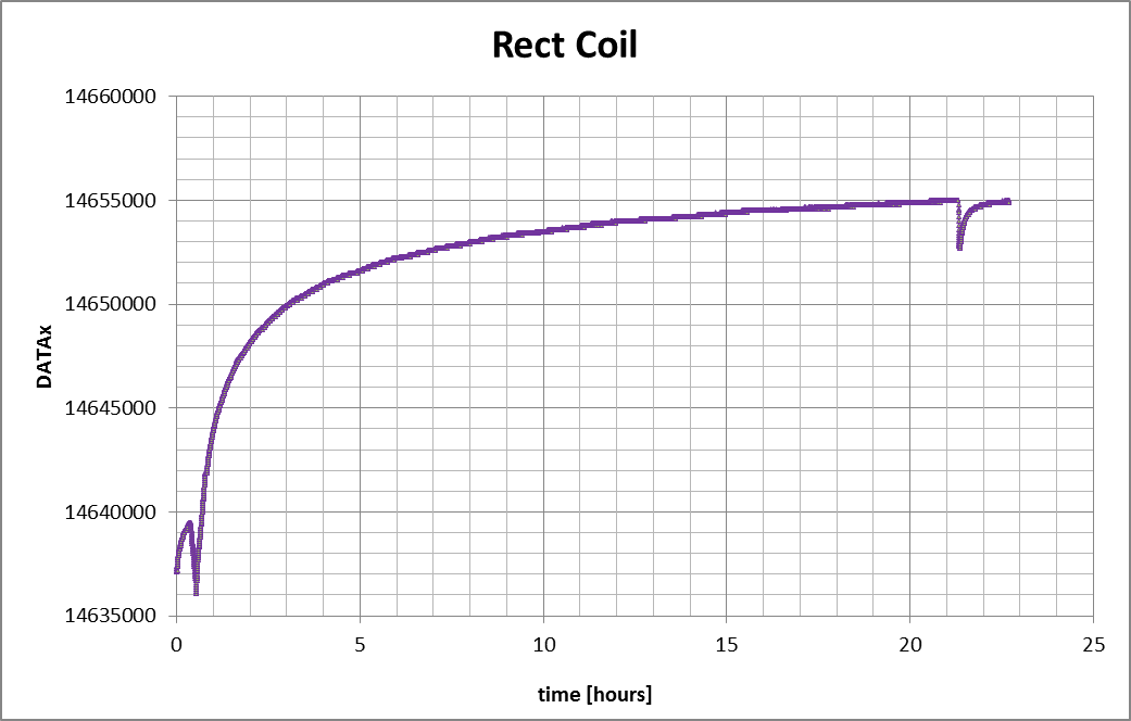

    Anyway, here is a test where I think I am doing something similar what was suggested.
    HW is custom build based on reference design, SW is also developed for this board – reporting basically only the LDC data to the host. There is one HW setup in the chamber with TI LDC1612EVM round PCB coil and another with rectangular PCB sensor intended for linear position sensing.
    •    In the beginning  the system is started chamber door open
    •    After roughly half an hour, the chamber door is closed and chamber operation is started to drive constant 30C
    •    After roughly 21hours of untouched logging, the chamber door is opened for few seconds and closed again.
    Here are the graphs, Ts = 5s, time in hours is presented as plain decimal number e.g 45 min = 0.75 hours.
