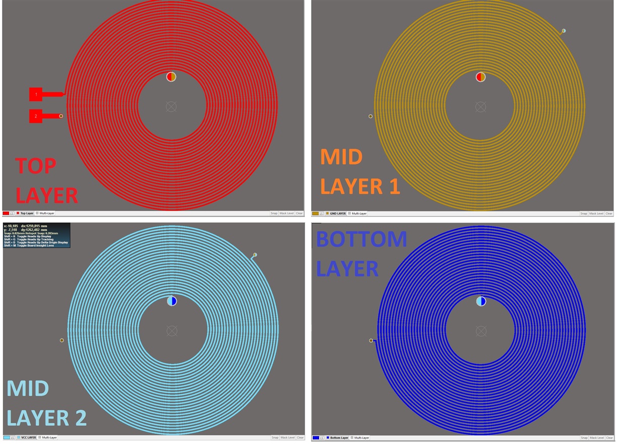

I'am using LDC1000 device with CTANK = 1nF and Lpcbcoil= 82uH (below the 4 layer PCB COIL LAYOUT used).
All vias are blind and buried, except that left via. The central via have a diameter of 0.6/0.8mm, while the others have a diameter of 0.2/0.3mm  . The copper tickness of coil is 42um for external layer and 35um for mid-layer, and the coil external diameter is 15.6mm .

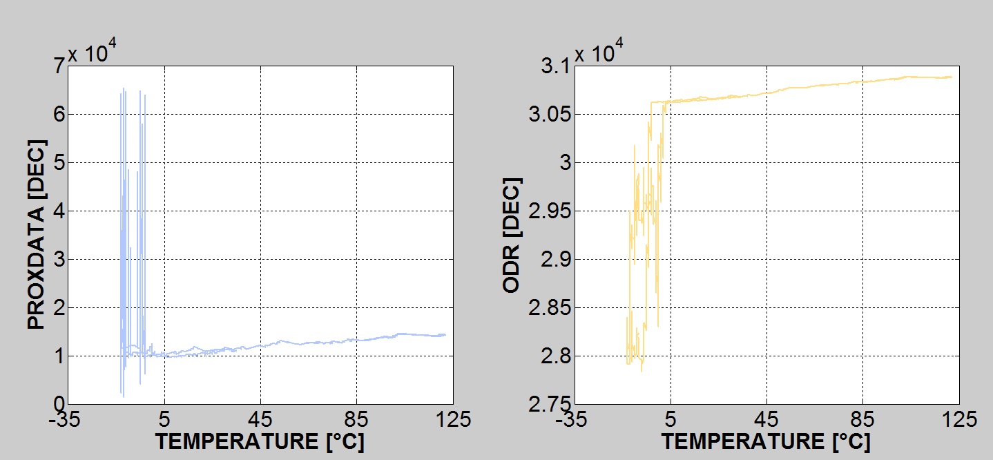

I performed a temperature test with this pcb coil, and I seen that for TEMP < 5°C, the ODR and PROXIMITY DATA behavorial is very strange (see below).
I take also care that the Rp escursion keep within the range [ 0.798 , 3926.991] kΩ .
Why does the COIL behave in this way ?? I think the problem is due to the geometry of COIL, but it's really so ??
  • I would check what's going on at CFB pin at low temperature. I suspect clipping
  • I used a CFILTER capacitor (between CFB and CFA pins) NP0 of 100pF in such way the peak-peak voltage on CFB pin is 1V .
    I tried with other board using a CFILTER capacitor NP0 of 20pF, but the result is same.
    I also tried to use other pcbcoil (L = 15uH) with CTANK = 100pF on the same board, and the problem doesn't show .
    How can I risolve the problem ??

  • Hello Carmine,
    It is possible that you have a PCB manufacturing issue with the coil. For example, if one of the vias is not well formed, this could produce continuity issues.
    ChrisO

  • Hi Chris,
    I tried to meas the pcbcoil series-resistance for many different temperature with multimeter, verifying that no continuity issues exist (the Rs increase linearly in temperature).
    Furthermore, I tried to reduce the CTANK capacitor by 1nF to 100pF (using the 4 layer coil shown above), and the strange behavior seen previously doesn't show. Why does happen this ?? Does it exist a reason for which this happen ?
    With best regards,
    Carmine Mennillo
    I'm using the 4 coil layout shown above for linear position application.
    We are still having problem with the temperature test: the graphic show below are obtained  keeping target in a fixed position. The temperature is set by -30°C to 100°C starting from room temperature and with a gradient of 0.5°C / minute .
    If we not the ODR curve we can see an hysteresis due to transient temperature of target (sensor and target have different temperature because the sensor reach first the set current temperature).
    If we remove the target, the ODR curve is perfectly linear as below.
     Have you ever experienced this situation ?
