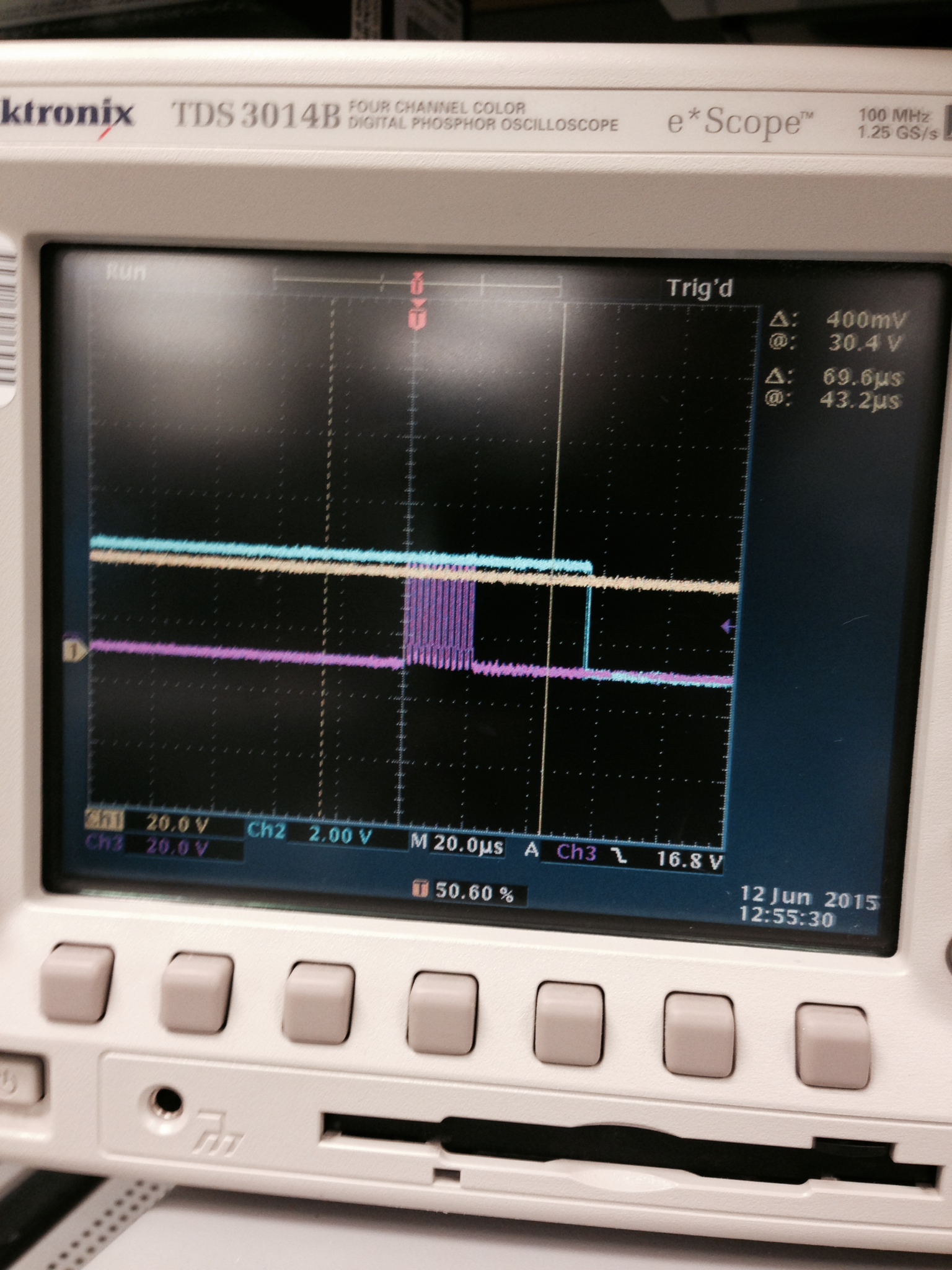

TDC1000-BSTEVM output
Other Parts Discussed in Thread: TDC1000
Hello
With reference to my previous post located at this link https://e2e.ti.com/support/sensor/ultrasonic/f/991/t/422763
We ordered a new board and followed the same procedure to get the 30V output on the TP2(30V) pin. But it looks like the new board is also not giving the desired results.
Could you please guide me how to debug this issue?
  • To resolve this issue, please do the following
    a) Enable "TDC1000-HV Boost Power Enable" checkbox in setup page
    b) Set the enable period as 150000. This field in GUI is actually us not ms. I think insufficient enable period is causing the issue.
    Vishy
  • HI
    The "TDC1000-HV Boost Power Enable" checkbox in setup page was already enabled. On changing the enable period there is no change observed in the output
  • I am checking this with the board designer. I will come back to you soon. thanks, Vishy
  • I got a TDC1000-BSTEVM setup with a TDC1000-GASEVM board and tested this issue. Enclosed here is the config file (TDC1000_Setup_gasevm.txt) I used. Once you are connected with the GUI to the TDC1000-GASEVM board, please load this config file. It sets up all the registers as well as the other parameters. Ensure in TDC1000 Register page "CONTINUOUS_TRIGGER" switch is ON (green). To check the board's functionality, I connected three scope probes on TDC1000-BSTEVM board: CH1 Yellow on TP2 (30V), CH2 Teal on J4.10, CH3 Purple on U2.6. Trigger is set on J4.10, falling edge. You can see the output in the enclosed scope shot file tdc1000-bstevm.jpg
    As you can see, the amplified transmit pulses are 30V level.
    Thanks,Vishy

  • Hey Vishy.. Thanks for testing this for us. This new configuration worked out for us. Main problem was with original board's broken boost converter. We ordered new board and that one seems to be showing expected behavior.
