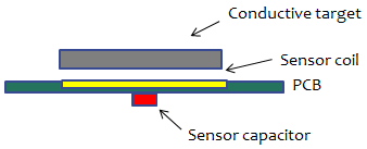

Hi Team,
I would like to ask about layout of sensor capacitor for LDC proximity application.
Is it reasonable to put sensor capacitor on underside surface of the board as the following?
I would like to put conductive target more closer to the sensor coil to increase resolution, however the hight of sensor capacitor prevent it.
Yaita
  • Hello Yaita,
    Sensor capacitor can be definitely placed on the bottom surface of the board as pointed out by you.
    The closer the target is to the sensor, the higher the accuracy of measurement.
    However, make sure the sensor capacitor is as close to the sensor coil (inductor) as possible so that the effect of parasitic capacitance is minimized.
    Please let me know if you have any other questions.
    -Best Regards,
     Suhas R C
