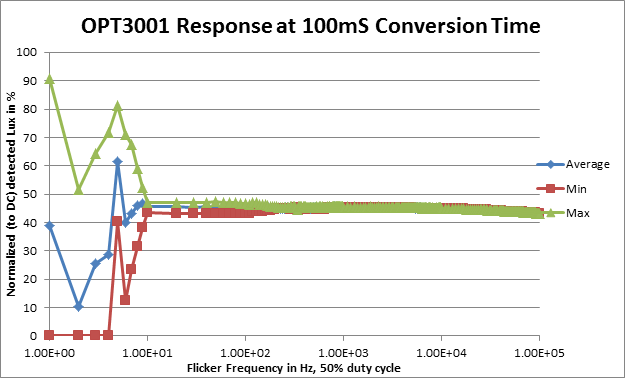

Some modern LED lamps have significant flicker amplitude at frequencies in the hundreds to the kHz range. How does the OPT3001 perform under such flicker conditions?
The issue is of course that unless the analog signal from the light to current sensor is properly anti-alias filtered before reaching the ADC, the measurement can be very wrong. Note that it may not be of any help to increase the integration time - the aliased-down signal cannot be removed digitally. Nor does it help to integrate in a multiple of the flicker period, because the period is unknown and varying, as it is not necessarily locked to the 50/60Hz grid.
The datasheet has no mention of an anti-alias filter nor a sampling frequency. Can anyone comment on these issues?

    We do see some effect from flicker at lower frequencies, under 1kHz. In my limited testing, I only saw up to about 10 lux of variation with an uncovered device. I also played with the duty cycle a bit and saw some effect there as well, but again, 10 or less. That said, it was me spinning the dial of a function generator, not a precision automated sweep, which seems to be in order to be able to actually say what the observed max variation is. Frequencies above 1khz did seem to average out, from what I recall.
    You can set up the experiment yourself with the opt3001evm as well. I'm out of the office on travel for the next week, but I'll see if I can get someone to set up something to check this out a bit more. Is there a particular range you're looking for?

    I have seen LED lamps modulated by 100Hz (rectified grid power) to few kHz. The challenge for light sensing is that the modulation depth can be high, because it is not limited by the LED bandwidth. High modulation depth operation it is not favorable for power efficiency and EMC reasons.
    The metric for sensitivity against source modulation should be in % not in Lux - should'nt it?

    I had my team take some data at 100mS and 800mS integration time.  Legal-type disclaimer: This is one unit, one sweep each integration time, room temperature, one light source, so it's not a guarantee of other unit or future performance, but it shows the performance as we saw it this one time.  We set the frequency, then took 10 samples and checked the min/max of those samples, reported here.
    Let us know if we can help further.
  • Thanks a lot for the detailed answer. It looks to work well even in high flicker conditions above the visual frequency range. May I suggest to add this very relevant information to the datasheet or at least an app-note?
