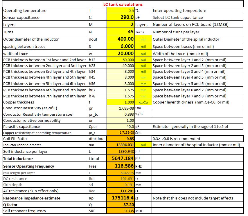

  • Hello Suhas,
    Thanks for sharing the link of software to calculate LDC inductance value.
    As stated earlier WEBENCH can take input only up to 7 cm to sense target. I was taking these figures as my reference
    For sensing 7 cm,
    Total inductance=387.25 uH
    Frequency=1 MHZ
    As distance to sense is directly proportional to Number of turns and Inductance.
    Hence for 20-30 cm -Number of turns and Inductance will be more.
    For designing for 20-30 cm sensing range what inductance and number of turns should I take (Since its only excel sheet and not simulation).
    I will appreciate any assistance you can give me at this point.

  • Hello Abhishek,
    I would target a coil 30cm diameter (or larger, if possible, for highest sensitivity) with ~5 turns.
  • Hello Abhishek,
    As Evgeny has mentioned, sensor coil of 30 cm diameter should be sufficient to detect the target.
    I will do my calculations and get back to you with suitable numbers for your application.
    -Best Regards,
     Suhas R C
  • Hello Abhishek,
    I have made some calculations with outer diameter of the PCB coil as 40 cm. Please find the values below:
    LDC1000 is more suitable for this application. Please let me know if you need additional information.
    -Best Regards,
     Suhas R C

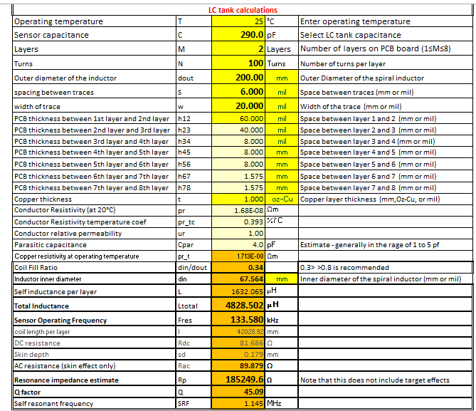

  • Hello Suhas,
    Thanks for your help for sharing the calculation for the PCB coil. In the calculation which you gave have D_out=400mm.
    Again due to some size constraint, I made it 200mm and increased number of turns which is now 100(earlier it was 45 )
    Other then that all values remains almost similar i.e. total inductance,self resonance freq, Coil fill ratio etc.
    I hope this small changes are fine with the design calculation you did and will not make big changes to detect the metal presence.
    Thanks and Regards,
    Abhishek Kadam
  • HI Abhishek,
    I would do only 5 turns so that the coil would be compatible with LDC1612. This IC will give you the highest sensitivity.
