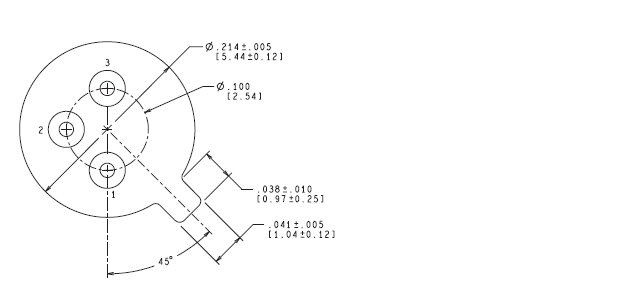

LM35AH datasheet drawing orientation wrong?
In the mechanical data section of the LM35AH datasheet, the drawing given for package "NDV0003H" is:
Pin 1 being VS, 2 being VOUT and 3 being GND. We understand this drawing is assuming a bottom view of the device, and this appears to agree with the photos of the device we could find online.
But in the section "Pin Configuration and Functions", the drawing given is:
Here a top view is assumed as per the figure , but it appears to be actually the bottom view, as it looks like just a rotated version of the previous figure. Can you please confirm if this is in fact the bottom view and not the top view
