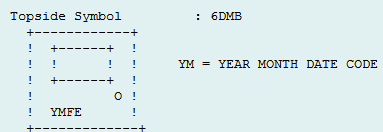

  • Hi Rolf,
    The date code is available in two locations,
    1. The label on the box/Reel.
    2. The physical marking on the device (it should be 57 (YM) for the datecode 1527):
      1. (HDC1000/8)
      2. (HDC1050)
    Carmine
