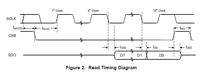

On page 7 (timing requirements) what is the t_IAG (Inter Access-Gap) or where can I find it in the diagram?

    The t_IAG is the minimum time that CSB must be held high before a new SPI transaction.

    With fastest possible ODR (12,8µs) and 48bit to read, it'll need about 266ns per bit.
    So data read is already pritty close to the maximum f_SCLK of 250ns (4MHz).
    Is it actually possible to deliver every measured value?
  • Hello Thomas,
    Yes, it is fast enough to retrieve all of the data; you are correct in that it is rather tight timing. If you are using a sensor with 5+MHz, you may consider looking at the LDC1101, which is a faster part - it can go up to 10MHz for the sensor, and has an 8MHz SPI bus.
