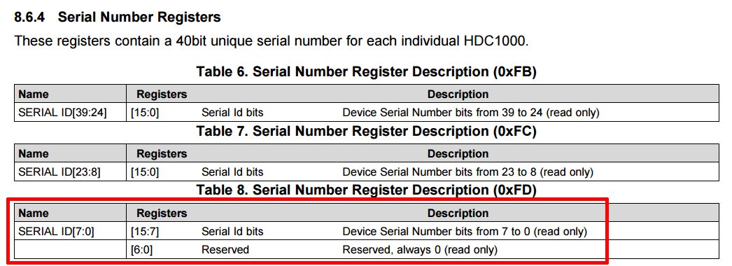

The SERIAL ID[7:0] is 8 bits on the datasheet.
But Serial Id bits[15:7] are 9 bits.
Is  Serial Id bits 8bits[15:8]?

  • Hi Kuramochi-san,
    Thank you for pointing out this question.
    The HDC1000 serial number dimension is actually composed by 41 bits.
    The correct serial number registers description is then the following:
    • Register 0XFB
    Name Registers Description
    SERIAL ID[40:25] [15:0] Serial ID bits Device Serial Number bits from 40 to 25 (read only)
    • Register 0XFC
    SERIAL ID[24:9] [15:0] Serial ID bits Device Serial Number bits from 24 to 9 (read only)
    • Register 0XFD
    SERIAL ID[8:0] [15:7] Serial ID bits
    Device Serial Number bits from 8 to 0 (read only)
    [6:0] Reserved
    Reserved, always 0 (read only)
    We are going to update the HDC1000 Datasheet with the correct information as soon as possible.
    Thank you again, and sorry for any inconvenience.
